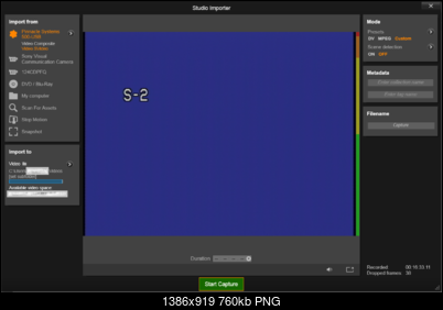

    I got about a couple of dozens of VHS-C in EP (1H30min) to be captured, The owner requested MPEG2 SD files so I have to use an MPEG2 capture software, The problem I'm having is I get about 1 second of lip sync delay in every 10min of video even when no dropped frames, Capturing video every 10min will take forever. Is there a stable way/software that I can use to accomplish this as fast as I can? Gosh I missed DV capture, The most stable way of capturing analog tapes ever.
    My hardware is:
    Dual core 2.93Ghz, 5GB memory, Windows 7
    Pinnacle 500-USB Capture Device
    Pinnacle Studio 19

    No, DV is not involved here at all, We are discussing whether to capture lossless and encode to the customer's choice or capture to the customers choice directly, As for the capture card which is the Pinnacle 500-USB as I mentioned above, What setting are you talking about? I don't have the option to change any setting, I'm capturing NTSC 4/3 720x480 interlaced in MPEG2 in Pinnacle application, VDub detects the setting automatically, It's pretty much cut and dry, I don't know what setting you are referring to? I just mentioned DV for its stability and locked audio feature which no one can deny that Vdub can't even come close to that level of audio sync precision even for 8 hrs LP VHS tape, Try to do that with VDub and see how many minutes of audio drift you will get.

    Lordsmurf, I can't use my inline TBC it makes the picture ghostly, I got one of those black shell ones, I got ripped off. Although for some tapes seem to work or at least it doesn't harm the integrity of the picture, Luckily Pinnacle capture app doesn't drop frames even without external TBC unless there is a blank section in the tape (static), there is damage to the tape or the tape mis-tracked during original shooting. I've captured 45min of Hi8 footage with zero drift.
    No you don't. That's probably part of the problem. Capture lossless, encode to MPEG afterwards. Very few capture cards can do MPEG well due to hardware for it (ATI AIW, Hauppauge PCI cards, Matrox, Canopus non-DV, etc).
    You're dropping frames, even if it's not reported. The other potential issue is audio is refusing to adjust kHz to maintain sync.
    This is fine.
    Pinnacle Studio 19
    This is terrible.
    Yep, that's the flawed chipset of the black AVT-8710. Terrible device now. Only the older green ones are good.
    The capturing software itself really can't/won't affect dropped frames (unless using 100% CPU), but it may fail to report the drops. That's more likely, especially with Pinnacle software (infamously bad).
    Hi8 usually isn't as troubled as VHS by dropped frames.
