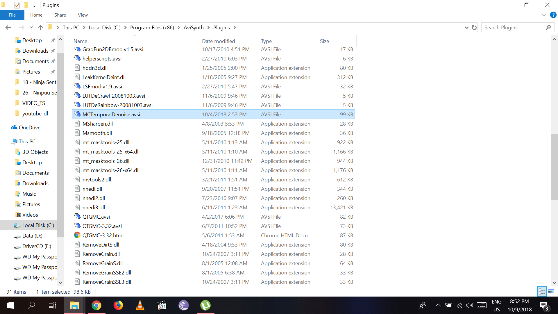

Results 31 to 59 of 59
  1. I have been following every single step and still no luck. What is wrong with my computer?
  2. I just wanna give up man. I have been finding solution. People give me how to do and still can't use that filter. It has been 1 year!! Maybe I am too noob. :") Still need to learn a lot even if I could use that filter. I am like stucking at the beginner's level.
  3. Are you sure that's the version of AviSynth you are using? Note that some programs install "private" versions of AviSynth -- MeGUI for example. Then there are 32 bit and 64 bit versions of AviSynth. The two have no access to the other's filters or plugins folder. If you you use a 32 bit editor/encoder/player then you need 32 bit AviSynth and 32 bit plugins. If you are using a 64 bit editor/encoder/player the you need 64 bit AviSynth and 64 bit filters.
    Note that MCTemporalDenoise isn't a plugin, it's a script. Therefore it will work with either 32 bit or 64 bit AviSynth -- but it needs to be in the correct plugins folder to autoload. If it isn't autoloading for some reason you can import it manually into your script with:
    import("C:\Program Files (x86)\AviSynth\plugins\MCTemporalDenoise.avsi")
    Of course, the plugins it requires must be installed for it to work:
    http://avisynth.nl/index.php/MCTemporalDenoise#Required_Filters
    If you have MCTemporalDenoise installed or imported correctly, but you are missing those other plugins, you will get an error message about those plugins.

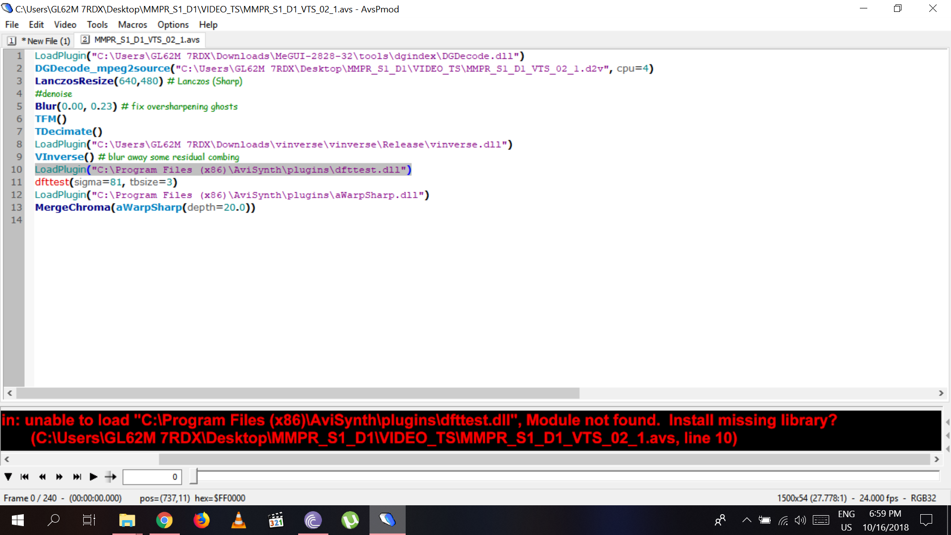

ID:	46950 Ystd, It was all okay. I can denoise with Dfttest and Finally, I was satisfied. Then I used aWarpSharp to sharpen color. Everything was ok, I could see preview until it opened like that today. IDK what is going on again. I have put that library in corresponding Window Folder. All went well ystd and I even encoded. However, as I want to copy some line from that .avs file and I found that happen and could not encode anymore.

  9. It's telling you what the problem is: dfttest.dll wasn't found. Check your path. Make sure the file is still there.
  10. And, although it won't affect this particular resize, it's considered a good practice to make the video progressive first (perform the IVTC) before resizing it. That blur line, too.
    If you can't figure out the DFTtest problem, Try loading it with a LoadPlugin line, the way you did with DGDecode.

    From http://avisynth.nl/index.php/Dfttest#Requirements:
    Download link for 32-bit version of fftw 3.3.5 Windows system dll's: ftp://ftp.fftw.org/pub/fftw/fftw-3.3.5-dll32.zip
    Create a new folder on your PC called "FFTW3". Download the fftw-3.3.5-dll32.zip file from the link above into that new FFTW3 folder. Unzip the .zip file, then in the files that are unzipped find "libfftw3f-3.dll".
    If using 32-bit Windows, copy libfftw3f-3.dll into C:\Windows\System32\
    If using 64-bit Windows, copy libfftw3f-3.dll into C:\Windows\SYSWOW64\

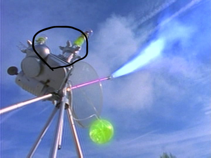

  17. VTS_10_1.demuxed.m2v Green ghost around the rangers
    help this too
  18. Are you talking about the green ghost to the right of the yellow character? The others don't have green ghosts.
  19. Originally Posted by jagabo View Post
    Yes. Well main point is I cant seem to Blur those ghosts (Not just green ghost, overall video)

  22. I didn't find any way to reduce the green ghosting to the right of the yellow character. But you can generally sharpen the picture, especially the colors (and get some minor noise reduction) with something like:
    Spline36Resize(320, 480)
    MergeChroma(aWarpSharp2(depth=5), aWarpSharp2(depth=15))  # Sharpen chroma much more than luma
    Sharpen(0.3)
    nnedi3_rpow2(2, cshift="Spline36Resize", fwidth=520, fheight=480)
    aWarpSharp(depth=3)
    Sharpen(0.3, 0.0)
    nnedi3_rpow2(2, cshift="Spline36Resize", fwidth=720, fheight=480)
    aWarpSharp(depth=3)
    Sharpen(0.3, 0.0)
    ChromaShift(c=2)

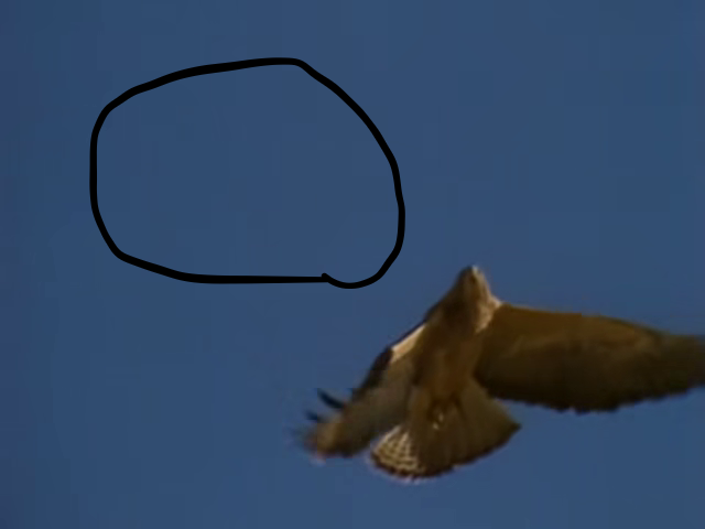

  23. Image
    [Attachment 50668 - Click to enlarge]
    how to remove those oversharpening edges.
    Also the blue sky becomes like this after I denoise and Blur the video
    [Attachment 50671 - Click to enlarge]
    Can you do the filtering?

  25. I wasn't able to come up with a way of removing the ringing at the edges. But they aren't so bad in the rest of the video. The posterization in the second image is common when you remove noise. 8 bit YUV simply isn't good enough to deliver very smooth gradients. You can leave some noise in the video or add some noise back with GradFun3 or GradFun2dbMod.
