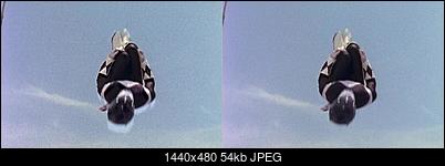

  8. That was some pretty sickly video. I didn't think there was away around the negative ghosting but I worked something out that doesn't seem to damage the rest of the video too much.
    Mpeg2Source("MMPR_S2_D2_VTS_10_1_1asw.m2v.demuxed.d2v", CPU2="ooooxx", Info=3)
    v1=SeparateFields()
    v2=v1.SelectEvery(2,1,0)
    Overlay(v1,v2,opacity=0.17)
    Weave()
    TFM()
    TDecimate()
    That leaves you with the original 23.976 fps film frames with no ghosting. Before and after:
    After that you can use whatever noise reduction and other processing you like.

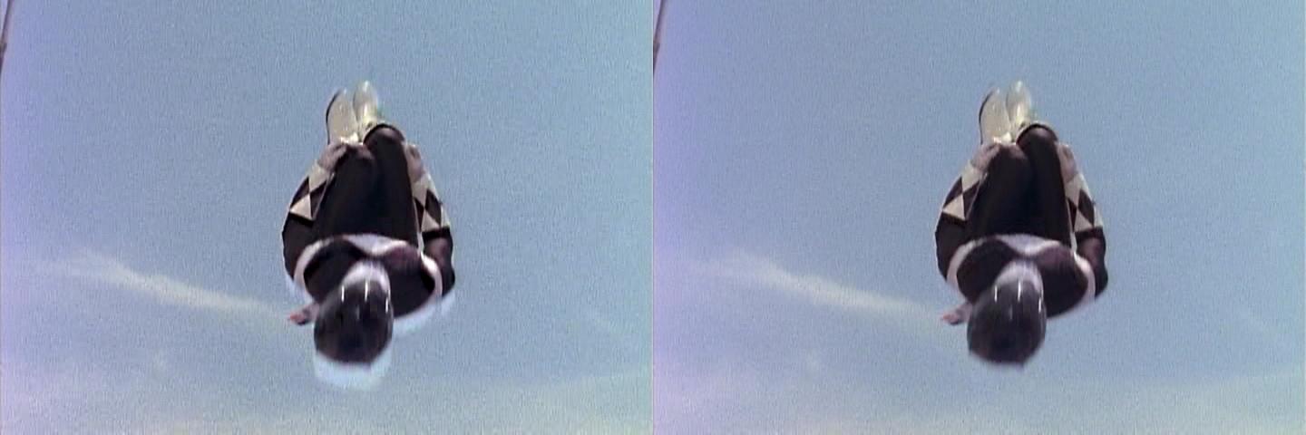

  10. After thinking more about how this video got those inverse ghost artifacts it occurred to me: someone ran a sharpen filter on the interlaced video. So the solution is much simpler than my original approach: reverse the sharpening with a blur. So the earlier code can be replaced with:
    Blur(0.3)
    TFM()
    TDecimate()
    There are many noise reduction filters. If you don't know AviSynth well you should probably go with something like MCTemporalDenoise() which is very powerful but has simple presets. There are some oversharpening halos that can be reduced with dehalo_alpha() and colors could use a little sharpening. So a more complete sequence may look like:

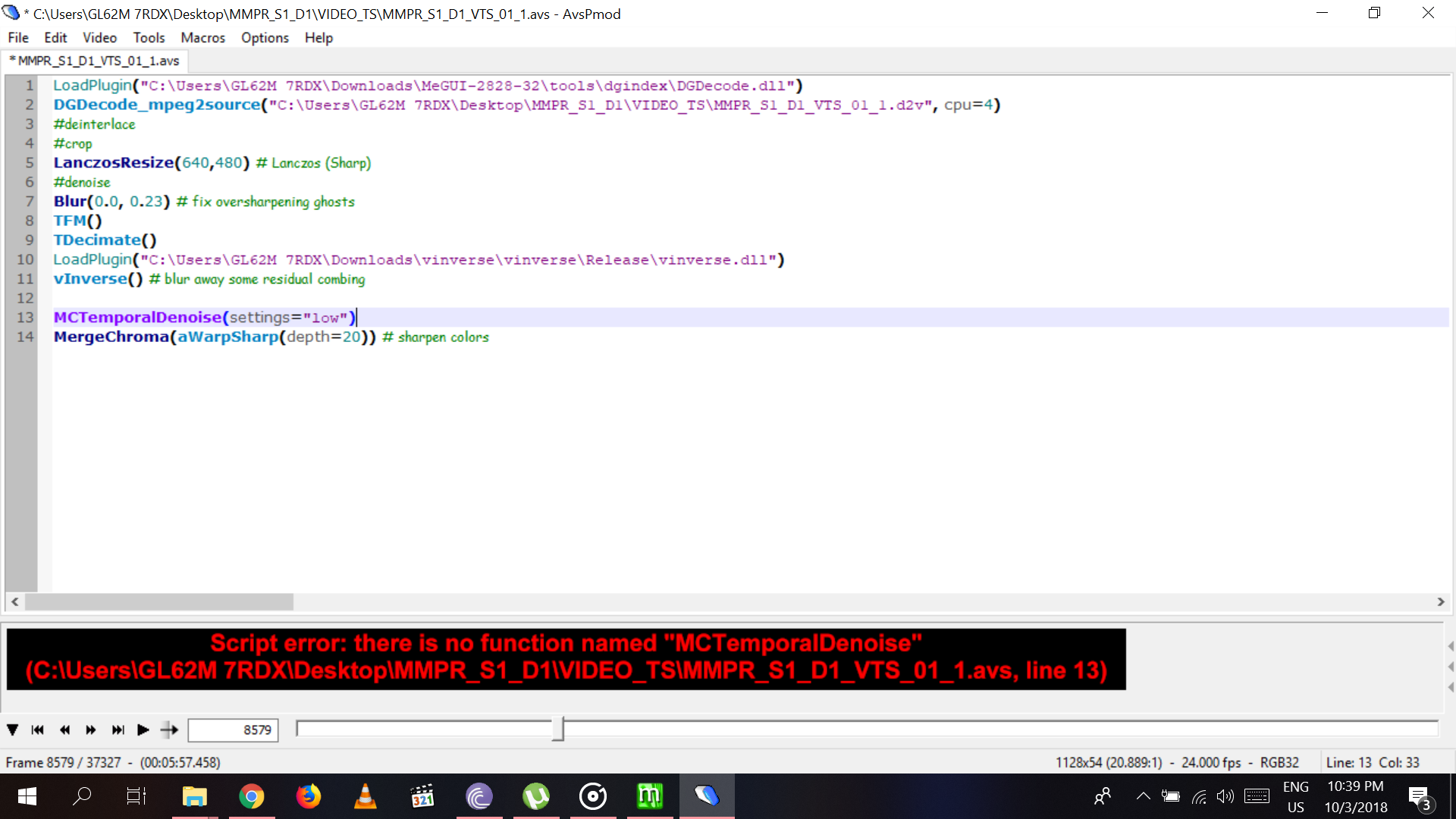

  17. Sorry for bothering jagabo... when I try to use ur code "Qtgmc" avspmod says that There is no function named qtgmc and i cannot use that line.... also Vinverse and Mctemporaldenoise too..... So sorry that i m asking u basic and easy questions but Can u tell me the steps to fully install avisynth and its filters so that i can use all of those filters? please jagabo
  18. I expect you already have AviSynth installed. To confirm, create a fresh AVS file named, maybe, Version.avs, and put a single line inside:
    Version()
    Open that in VDub and you should get a little picture showing the version of AviSynth you installed.
    As for the rest, unless it's a built-in filter you have to track it down and then either put it into your plugins folder or use the LoadPlugin or Import commands to add it to your script before actually using the filter. The best way to find them is to go to the AviSynth site and search. All three you mentioned are third-party filters you have to track down.
    Vinverse is easy. Always pay attention to the other filters needed to make them work. QTGMC is more difficult. MCTemporalDenoise is perhaps the most difficult of all to get working.
    Do some serious reading at that site to learn your way around AviSynth better. If you have questions, always post a complete script and the error message. If asking about a particular video, provide an untouched sample.

  26. MCTemporalDenoise.v1.4.20.avsi Filter returned invalid response to CACHE_GETCHILD_CACHE_MODE.266624824 (MCTemporalDenoise.v1.4.20.avsi, line 831). It appears when i load mctemporal filter and i cant use it. help me.
  27. If you're using a multithreaded build of 32 bit AviSynth try using a single thread.
