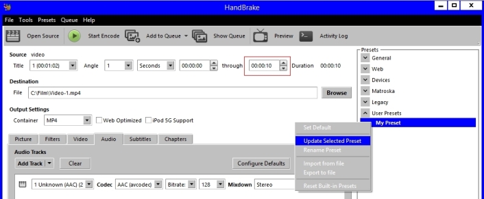

Since you are burning with HandbrakeCLI, https://superuser.com/questions/550710/how-do-i-translate-handbrakecli-options-to-ffmpeg-options has a pretty good write up with most of what you want to set if not all. I'm pretty sure if you change the video size though, you may have to adjust your subtitles again, at least PlayresX and PlayresY as suggested by videobruger in his excellent thread #58.
I would suggest you add a preset in HandBrake GUI and call it eg My Preset.What changes i need to make to the following code so the above properties listed in the code remain the same.
Change the settings using a small duration to test. When your settings gives the properties you want right-click My Preset and select "Update Selected Preset".
[Attachment 44417 - Click to enlarge]
Then change the batch to
Code:for %%g in (*.mp4) do ( ffmpeg -i %%g -i %%~ng.ass -codec copy %%~ng.mkv handbrakecli --preset-import-gui -Z "My Preset" --subtitle 1 --subtitle-burned -i %%~ng.mkv -o %%~ng_HC.mp4 del temp.mkv )
