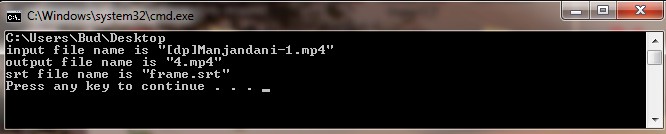

    [Attachment 44167 - Click to enlarge]

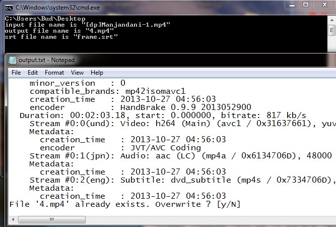

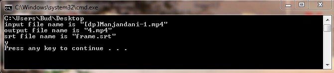

    The bad idea is that if you already have a copy of 4.mp4 you will not see the question asking if you want to override and the cmd window will just sit there unless you realize it and type y.
    [Attachment 44168 - Click to enlarge]
    If you wish to keep a log in case it hangs that you can open to look at then add 2> output.txt 1>&2
    to the end of the bat file and all will be written to a log file (output.txt) which you should be able to open if the batch fails or hangs

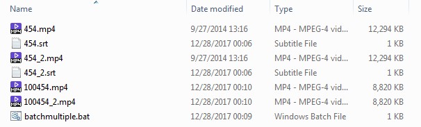

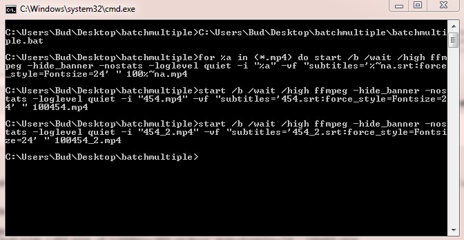

    You can use the same batch to process multiple files. Create a folder with all your MP4's and SRT's (with same name)and add a batch file containing:
    for %%a in (*.mp4) do start /b /wait /high ffmpeg -hide_banner -nostats -loglevel quiet^
     -i "%%a" -vf "subtitles='%%~na.srt:force_style=Fontsize=24' " 100%%~na.mp4
    [Attachment 44178 - Click to enlarge]
    This will create the files with embedded subtitles as '100xxx.mp4' names.
    [Attachment 44179 - Click to enlarge]

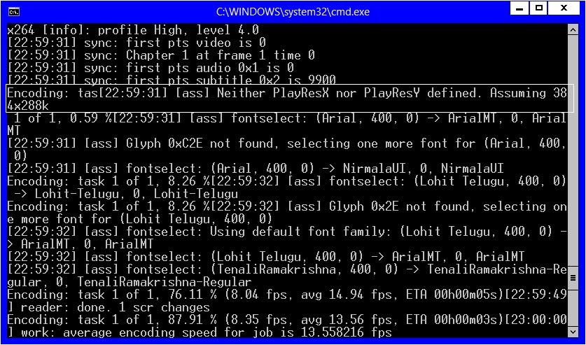

  16. Sir, I tried using the lohit font as described by you. but it didnot improve the situation.
    https://files.videohelp.com/u/274393/glyph_notfound.jpg
    See the error message it gave before it continued. Can you kindly suggest what i need to do.

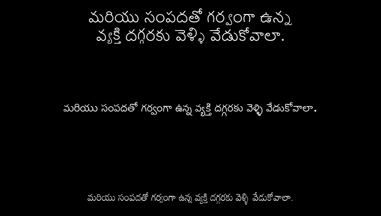

    For the 8th subtitle in your 851.srt
    [Attachment 44403 - Click to enlarge]

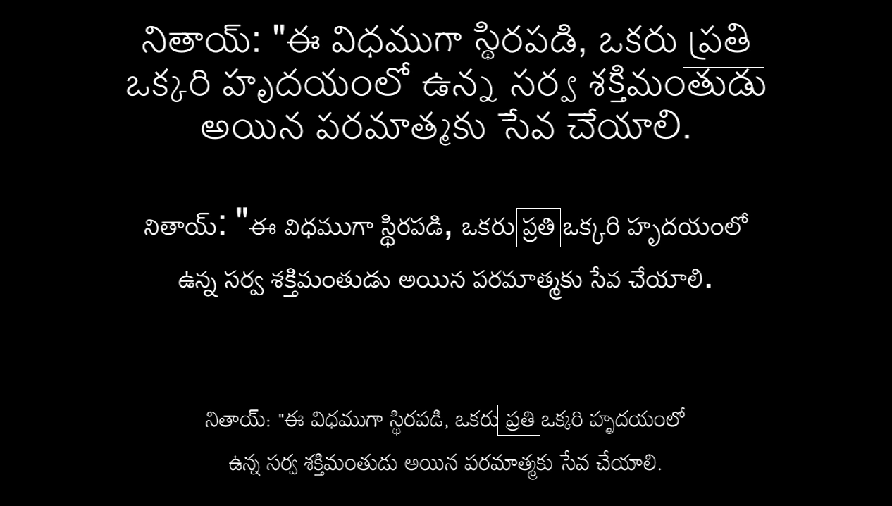

    the three fonts looks like this:
    [Attachment 44404 - Click to enlarge]
    I don't know Telugu so you need to decide which font looks "proper" to you. To me they all look proper but I noticed a difference in the 2nd subtitle depending on the font used
    [Attachment 44405 - Click to enlarge]
    that I marked in the image below
    [Attachment 44406 - Click to enlarge]
    From the above you'll see even though a size of 24 pt is used for all three font their size appears different when hardcoded. Your 851.srt is rather messy without any line breaks so when hardcoding HandBrakeCLI inserts line breaks as needed depending on the font and size

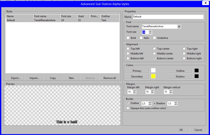

    This is done in a command window with the command:
    [Path to Subtitle Edit]subtitleedit /convert *.srt AdvancedSubStationAlpha
    If your files now are named 454.mp4, 454.ass, 455.mp4, 455.ass ... then your batch job looks like:

  26. s there any software which can change the font size of all the .ass files
    When you convert .srt to .ass with Subtitle Edit the font size in the .ass will be the one you use in the default style.
    [Attachment 44408 - Click to enlarge]

  27. yes, I am able to see now. After setting the format to .ass by clicking on the style button next to ass i am able to get the above screen and can change all files format and style.
    Great help.

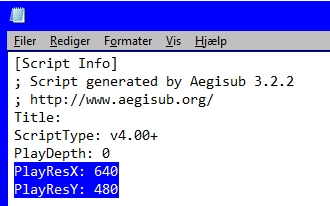

  28. And since size of the subtitle is a mojor issue for you this is for your info.
    In an .ass file beside setting the font size also the resolution of the display may or may not be set by PlayResX/PlayResY:
    [Attachment 44409 - Click to enlarge]
    Of course if PlayResX/PlayResY is set the subtitles are scaled accordingly.
    In your case PlayResX/PlayResY is not set so you get this message from HandBrakeCLI:
    [Attachment 44410 - Click to enlarge]
    As I said this is for your info and should have no consequence in your project.
  29. Sir,
    FFMPEG is also an excellent tool. But Why did it fail in UTF-8 fonts.
    Regards,
    Kamalakar
