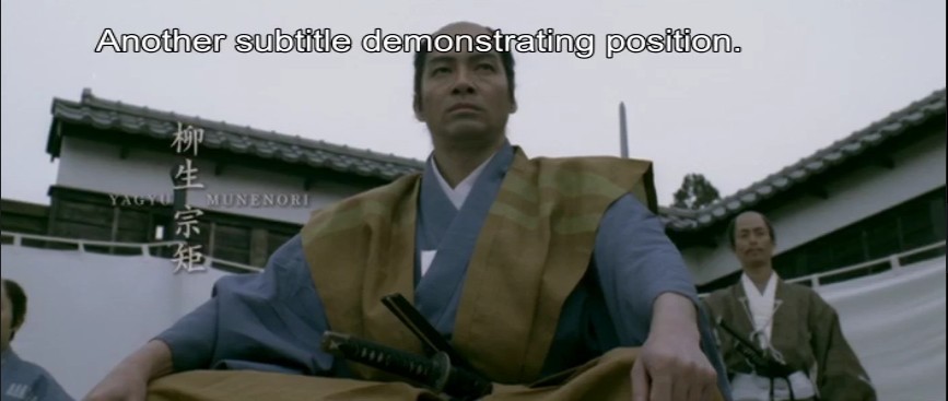

    It is possible to select color, size and position by using a combination in the SRT subtitles and the script for FFMPEG. Using the following SRT subtitle example:
    1
    00:00:01,000 --> 00:00:03,123
    This is the first subtitle
    2
    00:00:04,000 --> 00:00:06,000
    Another subtitle demonstrating tags:
    <b>bold</b>, <i>italic</i>, <u>underlined</u>
    <font color="#ff0000">red text</font>
    3
    00:00:07,000 --> 00:00:10,000 X1:40 X2:600 Y1:20 Y2:80
    Another subtitle demonstrating position.

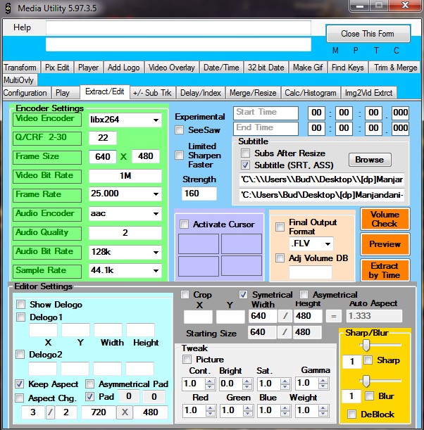

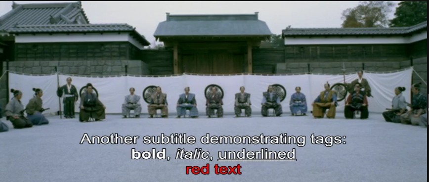

    ... and using the ffmpeg command to add SRT subtitles:
    ffmpeg -i "C:\Users\Bud\Desktop\[dp]Manjandani-1.mp4" -ss 00:00:00.000 -to 99:00:00.000 -vf "subtitles='C\:\\Users\\Bud\\Desktop\\[dp]Manjandani-1.srt:force_style=Fontsize=24,PrimaryColour=&Hffffff&'",scale=704:368,pad=704:368:0:0 -vcodec libx264 -crf 22 -r 23.976  -acodec aac -ac 2 -ar 44.1k -b:a 128k  "C:\Users\Bud\Desktop\[dp]Manjandani-1_Timed_2.mp4"
    [Attachment 44117 - Click to enlarge]
    ... and you will get a very nice combination of subtitle formats and size.
    [Attachment 44118 - Click to enlarge]
    [Attachment 44119 - Click to enlarge]

    Yes the larger subtitles are hardcoded, otherwise they would be normal sized. The menu was just to demonstrate and test the actual command line (they are shown in a pseudo command utility window used to test). I also included the ffmpeg command just in front of the image.
    Change the command or use it in a modified batch file for your use.

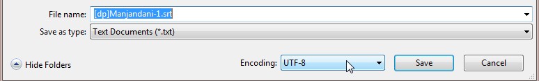

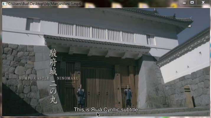

    I am assuming you mean with characters that may be outside your computers codepage character set... It always works for me to open the SRT subtitles in notepad and make sure all is correct including utf8 characters and save as UTF-8 format. This saves the 'Cyrillic' characters or similar and ffmpeg uses this file without problems at least on my Windows 7 computer.
    [Attachment 44126 - Click to enlarge]
    [Attachment 44125 - Click to enlarge]
    Additional information: If I run into filenames that my computer does not recognize such as Cyrillic filenames or containing Ellipsis characters or EM Dash (Long Dash), I add 'chcp xxxx' to the command line for whatever codepage recognizes it. In my case it is 'chcp 1252'. (chcp means change codepage)
    [Attachment 44127 - Click to enlarge]

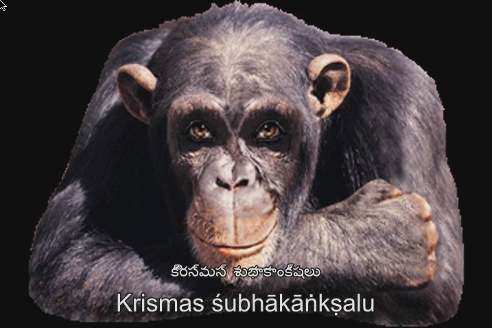

  11. My Mother Tongue is Telugu an Indian langugage. While making the srt files i save the notepad as UTF-8 characters option
  12. Member Budman1's Avatar
    Jul 2012
    NORTHWEST ILLINOIS, USA

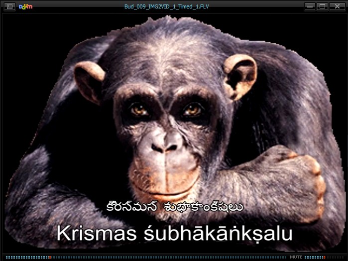

    Seems like FFMPEG accepts utf-8 OK and works fine
    FFPLAY
    [Attachment 44133 - Click to enlarge]
    FFMPEG Command Line
    [Attachment 44134 - Click to enlarge]
  13. You are very innovative and helpful. I never expected that you will wish me in my mother tongue. Great.

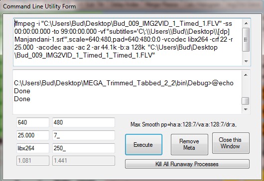

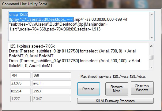

    You cannot open the command line Utility. It is part of a GUI program that I wrote to perform many of the repeated requests on this site. I use it to demonstrate and test that the information I give actually works with the actual command line. The Command line utility is simply a DOS (CMD) functional form that peforms the CMD function. If you see it there it will work in a normal CMD Window.
    Just open the FFMPEG scripts in a CMD Window and they should run the same as in my Utility, since it is simply a GUI CMD Window. My Utility
    takes video conversions (Image2Video, mp42flv, lighten, add subtitles, etc as noted by the tabs) and outputs the correct ffmpeg string for people to match against the images they come from.
    For Instance:

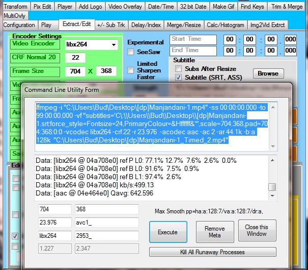

    I used the Image2Vid tab to create a 10 second video of my Avatar image. Then added the subtitles to the video with the Extract/Edit tab and hit 'Extract by Time' and it created the correct FFMPEG string which I can view, change or execute to make sure it works and that new versions of FFMPEG work as correctly as when I wrote the program.
    [Attachment 44136 - Click to enlarge]
    [Attachment 44137 - Click to enlarge]
    Notice how the above settings match the script below. This allows seeing how FFMPEG script is set up to match the requested functions.
    [Attachment 44138 - Click to enlarge]

  26. Member Budman1's Avatar
    Jul 2012
    Okay... slowly now. You have been adding stuff and causing more errors.
    First:
    When you use the full path name in the subtitles filter you must use the backslash to escape the colon and backslashes in the name since they mean something else in FFMPEG and you must use an additional backslash as shown in my ORIGINAL example.
    -vf "subtitles='C\:\\Users\\Bud\\Desktop\\[dp]Manjandani-1.srt:force_style=Fontsize=24,PrimaryColour=&Hffff ff&'"
    Second:
    ffmpeg -i %input_file% -vf "subtitles=' %srt_file%:force_style=Fontsize=24,PrimaryColour=& H000000FF' " -c mov_text -c:v copy -c:a copy -vcodec libx264 -crf 22 -r 23.976 -acodec aac -ac 2 -ar 44.1k -b:a 128k %output_file%
    Will NOT work. The errors in this is:
    1. FFmpeg is very specific where and what you type.. You put extra spaces in the areas in red above.
    2. You left off the final & after colour 000000FF as in blue. This will give you Black color subtitles
    3. -c mov_text is used for creating a subtitle TRACK not embedding.
    4. -c:v copy says to copy the video but you cannot copy when re-encoding for hard subs. This is also overridden by the -vcodec selecting libc264 codec later
    5. -c:a copy says to copy the audio, which you can do since it is not being changed due to encoding video but -acodec overrides it again with aac codec (one or the other).
    Your batch will work as :
    @echo off
    set folder_name ="c:\users\bud\desktop"
    cd %folder_name%
    cd upload
    set input_file="[dp]Manjandani-1.mp4"
    set output_file="4.mp4"
    set srt_file="frame.srt"
    echo input file name is %input_file%
    echo output file name is %output_file%
    echo srt file name is %srt_file%
    ffmpeg -i %input_file% -vf "subtitles='%srt_file%:force_style=Fontsize=24,PrimaryColour=&H000000ff&'"^
     -vcodec libx264 -crf 22 -r 23.976 -acodec aac -ac 2 -ar 44.1k -b:a 128k^
     %output_file%
    You change directories to the one with your files so no folder name and extra escape characters (backslash) are needed, otherwise your folder name should have been set as: folder_name ="c\:\\users\\Kamalakar\\Desktop\\"
