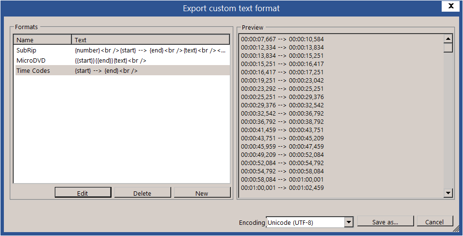

  3. Not sure what it is you want.
    But in Subtitle Edit you could use Files -> Export -> Export custom text format and define a template (Time Codes) to export the time codes. Then open it in a spreadsheet and manipulate them anyway you want and export as text again,. Then in Subtitle Edit use File- > Import time codes
    [Attachment 44090 - Click to enlarge]
