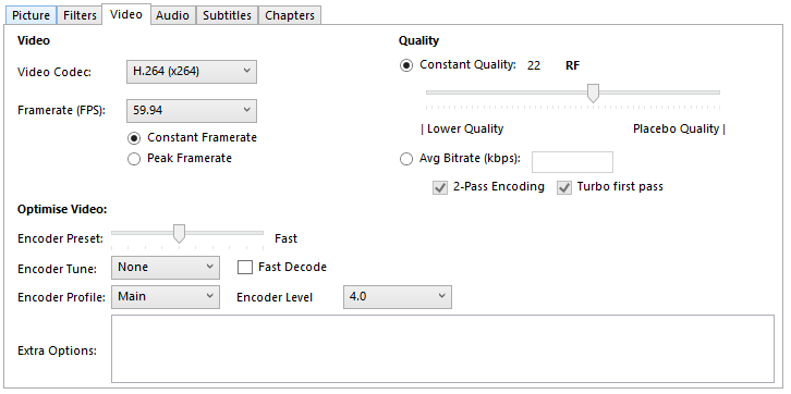

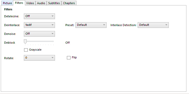

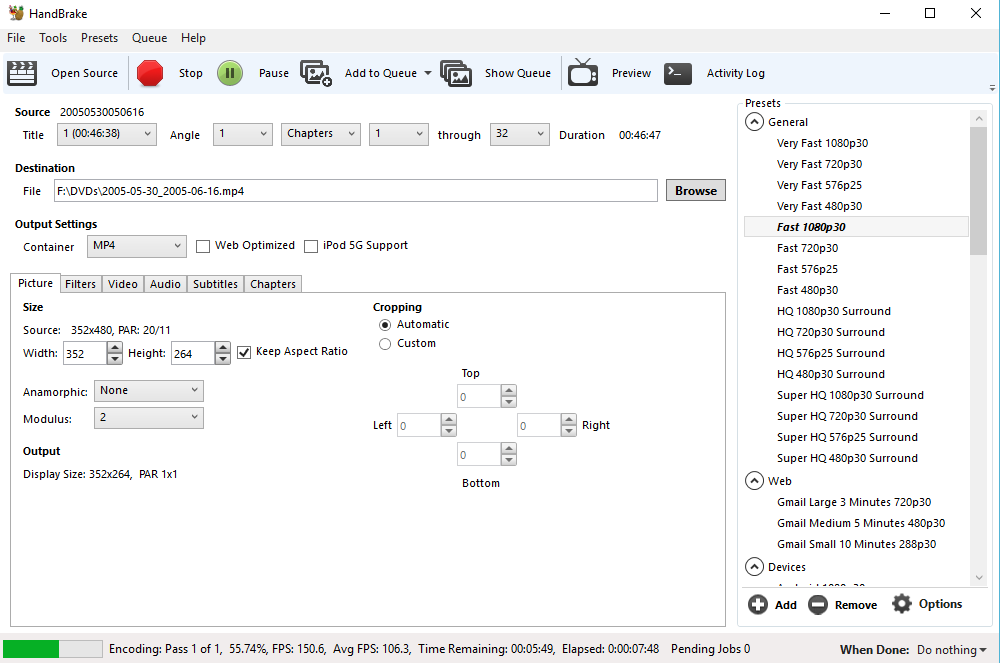

    On the Filter tab select Deinterlace -> Yadif. On the Video tab select Frame Rate -> 59.94, Constant Frame Rate.
    Oh, it's that easy? Great. Do the attached HandBrake settings look good? It won't let me adjust the width, so it forces it to 352x264. Is that OK, or is there another workaround?

  4. You want 640x480. I don't keep up with the latest changes in Handbrake -- but in the past it wouldn't let you enlarge the frame. You will lose nearly half the vertical resolution if you decrease the height from 480 to 264.
    The techniques at 100fps are outdated. The best deinterlacer is now QTGMC in AviSynth. But it's a pain for beginners to get set up and there's a steep learning curve.

    For anyone else following along, I did figure out a way to enlarge the frame on Handbrake. Click "Options" and then "Reset Built-In Presets." Now it will let me change the resolution from the 352x480 input to 640x480, and then change all my other options to what I want. This seems to be a fact not well-known. All other threads I read on this issue seemed to conclude you can't increase the frame size in HandBrake. But this way seems to work, and it makes a big difference in quality.
    Speaking of which, I've read on other threads that it doesn't make a difference to increase the frame size: after all, since you only have 352x480 pixels of data, stretching it to 640x480 just stretches out the pixels, so you might as well use the more compact 4:3 format of 352x264, since you only have that much data to work with anyway. This is absolutely not true! Not that I understand why, but I compared a 352x264 video to 640x480, and there was a huge difference in quality. All other parameters were the same. Go for the the 640x480, like jagabo was saying.

  7. Originally Posted by schipman3 View Post
    You may not gain anything by stretching the width from 352 to 640. But by doing so you avoid having to decrease the height from 480 to 264. Ie, you avoid losing half the vertical resolution.
    I don't normally use the program but thanks for the tip on how to get Handbrake to enlarge the frame. On the version I have, 1.0.7, it's also on the Presets menu, Reset Built-In Presets.

    For the sake of other amateurs like myself trying to accomplish the same task (i.e., convert half-width 352x480 DVDs recorded by a digital camcorder to a versatile, digital format - .mp4, .mkv - that will display properly in most any media player, enabling you to store the files on and play from an external drive onto TVs, PCs, and other devices), here is a summary of the process I am using:
    1. Download and install Handbrake.
    2. Load DVD and set as source in Handbrake.
    3. "Reset Built-In Settings" so that Handbrake will let you increase the resolution. I have to repeat this step for every DVD.
    4. On the "Picture" tab set width and height to 640x480.
    5. On the "Filters" tab, set Deinterlace to Yadif.
    6. On the video tab, set framerate to 59.94 and radio Constant Framerate.
    7. Set your output folder and encode.
    I use the default Fast 1080p30 preset. I did not notice any increase in quality using a SuperHQ setting, and it takes much longer. If you want, you can create another preset based on the Fast 1080p30 but with the deinterlace and framerate settings preset so that you don't have to redo those every time. I still find I have to "Reset Built-In Settings" each time though to get it to let me increase the resolution.
