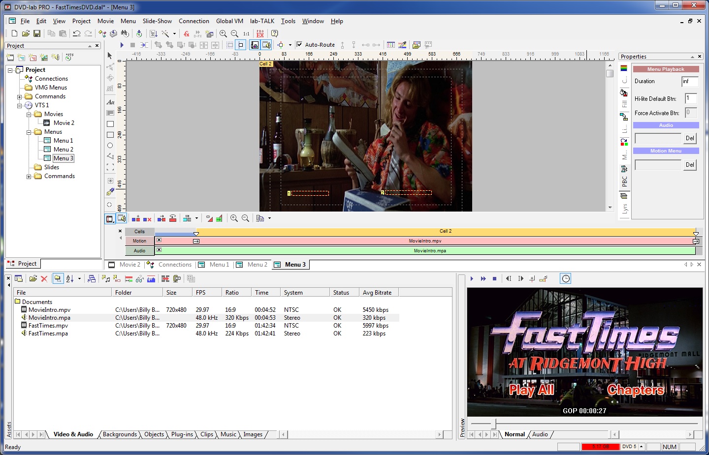

I see the delayed cell, which is what I want (or at least what I want for now, I may change my mind later...). So, this may be a stupid question, but I added a new cell and put my rectangles on it that I'm going to use for links, but no matter which of the 2 cells I click on, I only see the very first frame of my motion menu movie. So, how do I know where to position these rectangles? I can't see the frame that will be the first frame they appear on, and there doesn't appear to be any button to "preview" my motion menu.
For example, I've got the rectangle links in the top portion of the screen. They should appear in the menu in the bottom right portion of the screen. But I have no idea if they'll line up, because I can't preview the menu with the links in it.
[Attachment 44076 - Click to enlarge] -
it's been a long time since I used this prog and never bothered with motion menus since all menus are generally overkill.
But if you read the help page for motion menus you will see that you should lay your buttons on a blank menu and create the links BEFORE you add the video.
