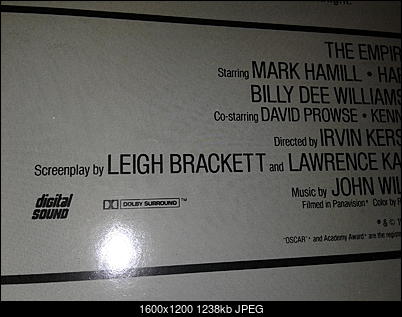

    Originally Posted by So my card's toslink must be set up for adat and the coax rca is s/pdif.[/QUOTE
    Yes. I told you that in my initial reply to this thread.
    Yes sorry [usually quiet]. I didn't understand that adat and s/pdif were different , that's why I missed your explanation of the Focusrite documentation.
    Originally Posted by clashradio View Post
    I've read about guy named "hairyhen" over at the Star Wars Original Trilogy site that extracted the 5.1 mix from the 1993 DC laserdisc.
    You are mistaken. DolbyDigital was not used on LaserDisc until 1999, for the Japanese release of Star Wars: Episode I – The Phantom Menace.
    I know the 1999 Japan Episode 1 had 6.1; are you thinking of that as far as Dolby not being on LD's until 1999? Attached is a pic from my 1989 U.S. Empire Strikes Back LD that says 'dolby surround". That same symbol is on my 1992/93/95 releases of Star Wars as well. I admit I'm a newbie to surround, and I know some of the earlier discs actually said "AC-3" on them. But is Dolby Surround the same as or another name for ac-3?
  18. Member
    Aug 2006
    It appears that DolbySurround is a digital audio format used for home video, which predates Dolby Digital AC3. It can provide either stereo or 2.1 channel audio.
    Wikipedia says the following in its Dolby Pro Logic article:
    Dolby Surround is the earliest consumer version of Dolby's multichannel analog film sound decoding format Dolby Stereo. It was introduced to the public in 1982 during the time home video recording formats (such as Betamax and VHS) were introducing Stereo and HiFi capability. The term Dolby Surround is used so as not to confuse theater surround (Dolby SR, which has four channels of audio) with home stereo, which has only two. The term also applies to the encoding of material in this sound format. It was capable of decoding Dolby Stereo stereo tracks to 3.0 channels (Left, Right, frequency limited single Back channel).
    [Edit]The Wikipedia article for DolbyDigital says that Before 1996, Dolby Digital was marketed as Dolby Surround AC-3, Dolby Stereo Digital, and Dolby SRD. In 1995, the LaserDisc version of Clear and Present Danger featured the first home theater Dolby Digital mix.
    So, the first LaserDisc with AC3 sound appeared in 1995. It seems to be 5.1 audio. Now it looks like only discs released in the final 6 years of production could have 5.1 audio.
    Jun 2011
    [Attachment 44098 - Click to enlarge]
    No. AC-3 (or Dolby Digital) is not the same as Dolby Surround. Dolby Surround is a crude analog surround format used before Dolby Digital and DTS were adopted in home theater systems.
  20. Member Cornucopia's Avatar
    No! You are conflating different, separate things. (somebody beat me to it...)
    Dolby Surround is a 4->2->4 (later 5->2->5 etc with DS ProLogic) matrixing scheme. It is architecture-agnostic, so can be used in analog or digital. It has been around since late 70s/early 80s.

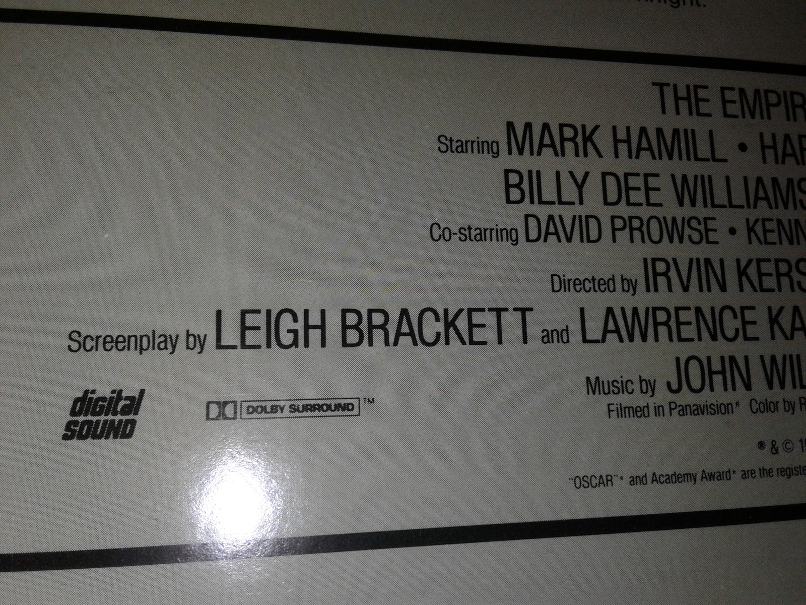

    Ac3 is only digital (hence "dolby digital"), and and ALL discreet (aka not matrixed), and has only been around since about 1993, and as mentioned only appearing in LD in 99 or later.
    Since the middle state of DS is 2 channel, it is very easy & straightforward to put the Lt+Rt signal in the normal stereo/2ch spot, and that is what media companies have done for a long time for media that only supports 2ch: pre-ac3 LD, VHS/SVHS/Beta/8mm/Hi8, VCD. Even some audio-only media use it: CD, LP/45, Cassettes, MD.
    To "extract" surround from DS material, just capture the standard 2ch stream, and then tell your player/TV/AVreceiver to decode the stereo as DS. Done.
    Or, cap as stereo, then later decode & upmix to 5.1, etc. and save the multitrack as whatever you want: separate channel files, 6ch wav, ac3 5.1, dts, etc, to save the extraction permanently. Note however that this just saves the guessed-at upmix, so it is an approximation of the mix.
    In fact, due to the incomplete and destructive nature of matrixing, any DS material will ALWAYS be a higher crosstalk approximation. It will never again be equal to the original multichannel mix.
    Another reason why it is only used as a last resort (when no multichannel options are available).
    @usually_quiet, wikipedia got a lot of that wrong, or at least only partially right.
    Aug 2006
    That figures. In any case, Dolby Digital /AC3 5.1 audio was only available on LaserDisc releases for a few years near the end.
  22. Member
    Nov 2006
    Thanks [Cornucopia] & [usually quiet]. It's been a real journey learning the best method for LD to BD, ac-3 audio, adat & s/pdif, Dolby Digital and Dolby Surround. Your info and help has been much appreciated!
