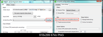

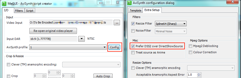

    The easy way to use it is to just go into the script creator and create a new avisynth profile with DSS2 prefered. Then the next time you want to index a file, click the directshow instead of the other options. And it will use DSS2 instead of Directshow.
    Example
    LoadPlugin("C:\Program Files (x86)\Haali\MatroskaSplitter\avss.dll")
    dss2("O:\To Be Encoded\Source.ts", fps=29.970, pixel_type="yv12").AssumeFPS(30000,1001)
    A big hang up with me and DSS2 is that it usually just assumes everything is YUY2, even though just about everything (especially if you are a novice) is going to be YV12. So I have to put pixel_type="yv12", as shown in my example script, to force it to decode it as YV12. Otherwise megui will ask to add converttoyv12(), which will hurt quality a very tiny amount but noticeable with red colors. I personally manually add pixel_type="yv12" every time, until I think of something automatic.
    There are some nuanced frame accuracy problems with it since it does not build an index. Mostly having to do with trying to watch the video backward, instead of forward. So if you are simply doing a script to play the video from start to end then there should be no problems.
    In megui when the preview window pops up the first time, showing you the video after clicking "Directshow", just close that preview as it's glitched with DSS2 (to put simply). After closing that preview window get your script how you want it and press the preview button manually which should work better.
    DSS2 uses Haali Media Splitter, which you might need to download and install.
