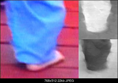

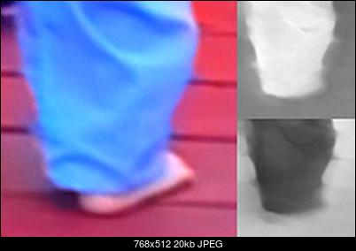

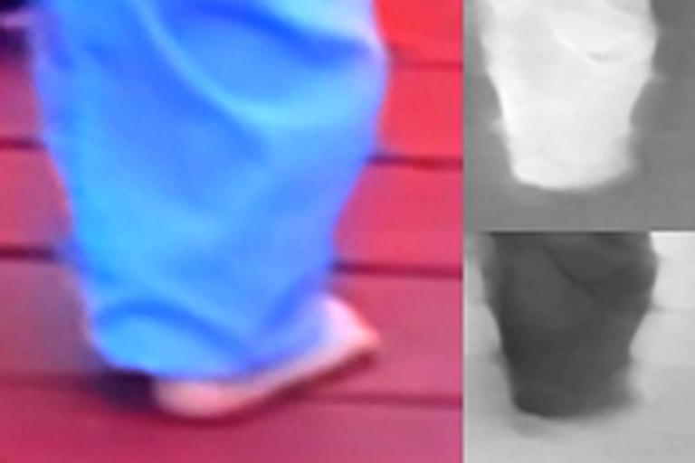

  5. It's a very weak noise reduction filter. You can barely see the difference. But it does appear to be causing some color bleeding. I'd leave it off and filter later in software.

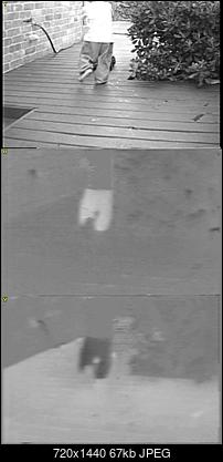

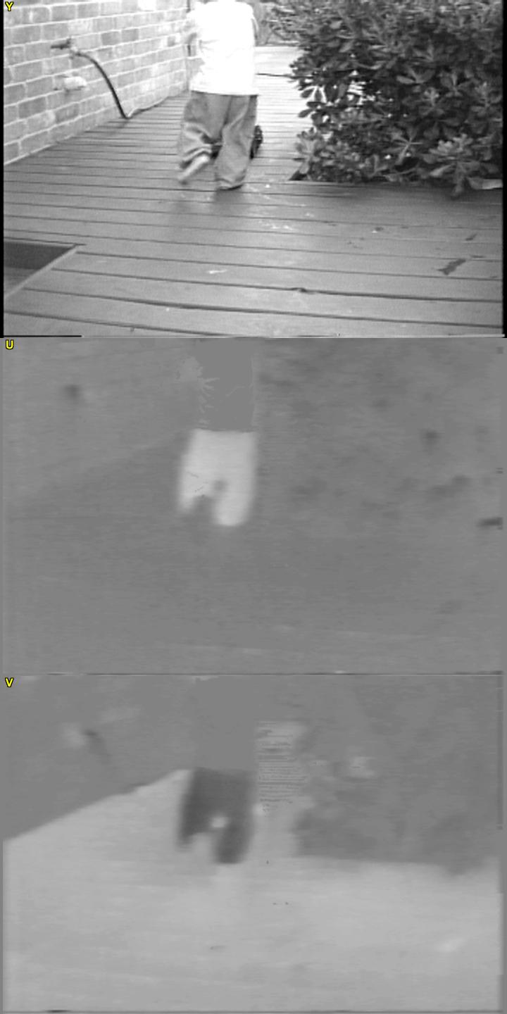

    And don't capture as RGB, capture as YUY2, UYVY, or some other YUV 4:2:2 subsampling. You've crushed super darks and super brights that could have been recovered.
  6. Originally Posted by jagabo View Post

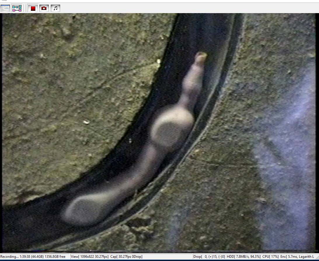

    As for my videos being in RGB I forgot to check direct stream copy in virtualdub when I was trimming the samples, but Im capturing in YUY2 lagarith. Thanks.
    Anyone know what the Drop [0, +15, -0] in the lower right corner means?
  7. I filter with AviSynth. But it has a steep learning curve. A sample with moderate denoising is attached. You can go stronger or weaker, of course.
    Regarding the Drop: I suspect it means no frames were detected as dropped (missed from the source device), 15 frames were inserted, and no frames were deleted -- to maintain the requested frame rate. Your capture should be 29.97 fps, not 30.27. Something isn't quite right.

    I didnt notice it before, but now I've made a huge error and believe I see what you meant.
    I left the battery outside of the camera, and since the camera is 20 years old I'm sure the CMOS battery is dead too. I assumed the camera would hold my DNR settings so I havent checked it in a while, thats where my mistake lays. Not sure how many tapes have been shot like this, guess its time to go through them to look for color bleed and re-digitize.
    https://mega.nz/#!9HAGhCjY!TXUGwMAGWqLK5scE05M1tqaZgGrW6pS-ib0xVzKlUwU
    (not in YUY2 because i didnt click direct stream copy)
    Notice the grey bricks on the left - theres a redness to them matching the porch deck that comes and goes - thats color bleeding right? I was so close to the finish line too, hah.
  25. Originally Posted by videon00b View Post
    Some of the bricks are red-ish but that's not color bleeding. Later in the clip there's a round red object on the table in the background. Notice how the red color sloughs off to the right of the object -- that's color bleeding. You can also see it to the right of the blue jeans against the red porch. Consumer analog video tape has very low color resolution. You always get color bleeding like this. Here's a image of the Y (greyscale), U and V (color) channels:
    View it full size and see how blurry the U and V channels are. The contrast of the chroma channels has been increased to make them more visible.

  27. Your video has pretty muted colors. Bleeding colors are more noticeable with more saturated colors. If you crank up the saturation and enlarge the frame you can see it better.
    Before (bobbed, cropped, and enlarged 4x):
    Notice as you move from the blue at the center to red at the right how the color changes from blue to purple to red. You can see the chroma channels on the right are very blurry.
    After sharpening chroma (too much, to make it more obvious):
    The transition from blue to red is much sharper and cleaner. The chroma channels are much sharper (though there are some artifacts).
    The bleeding is relatively minor in this clip. It is much more prominent on second or third generation tapes.
    A DNR filter should not have significant effect on color bleeding. It will only reduce noise. Here's the sharpened chroma image with the addition of very strong noise reduction:
