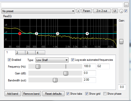

  1. Iam trying to record some sound disturbance using condenser mic and audio interface. Having absolutely 0 knowledge on this subject i quickly found that cranking mic gain to the max, in hope to catch everything, will make it even worse due to all the introduced noise. Sometimes i get better results with lower mic gain and some post processing after.
    Could someone steer me in the right direction, maybe advise a correct workflow for recording low freq. sounds, or some plugins that i need to investigate?

  3. Its a footstep sound (somewhat deep) with yelling in the background. I think i lose a lot of it due to electronic noise caused by hardware gain i applied to the mic.
    Here is what it looks like with mic gain turned to the max:
    This clip i recorded with about +9db additional gain on band 2.

  9. Thanks for all the tips. Suspending my mic on rubber bands did show improvement on the graph.
    However, i think i went totally wrong with the mic choice. Iam using behringer ecm8000, an omni directional measurement mic. Which is worst for what iam trying to record, due to it's small capsule size? Will something like Rode nt1-A show much improvement?
