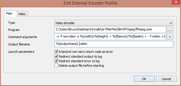

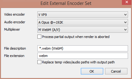

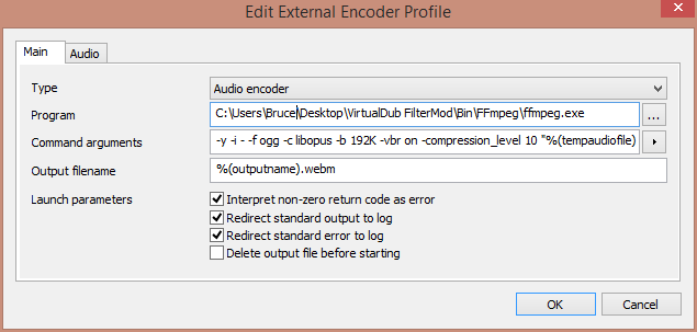

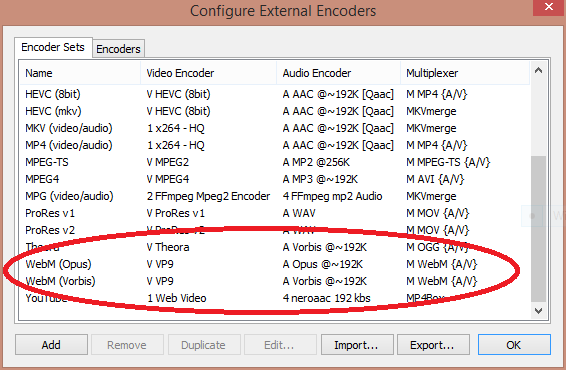

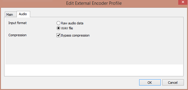

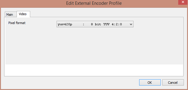

  1. I'm trying to use the WebM (Opus) encoder set.
    The command arguments for the V VP9 video encoder are -y -f rawvideo -s %(width)x%(height) -r %(fpsnum)/%(fpsden) -i - -f webm -c libvpx-vp9 -b 0 -crf 18 -threads 8 -speed 2 -tile-columns 6 -frame-parallel 1 -auto-alt-ref 1 -lag-in-frames 25 "%(tempvideofile)"
    The command arguments for the A Opus @~192K audio encoder are -y -i - -f ogg -c libopus -b 192K -vbr on -compression_level 10 "%(tempaudiofile)"
    I keep getting an "anonymous pipe" error. How do I fix it?

  3. It looks like ffmpeg doesn't receive data from pipe (at least error type and ffmpeg command-line suggest such problem) - if you are desperate you can always use ffmpeg directly with your video outside virtualdubmod.

  10. Export and post your preset (.vdporf file)
  11. Originally Posted by shekh View Post
    Sorry, how do you do that?
  12. From "Configure External Encoders", press "Export...", save to file.
    If you can, delete everything irrelevant (if you have many other presets).

  28. So the problem was filename conflict
    Instead of
    "outputFilename": "%(outputname).webm"
    Should specify distinct names for audio/video
    "outputFilename": "%(outputname).Audio.webm"
    "outputFilename": "%(outputname).Video.webm"
