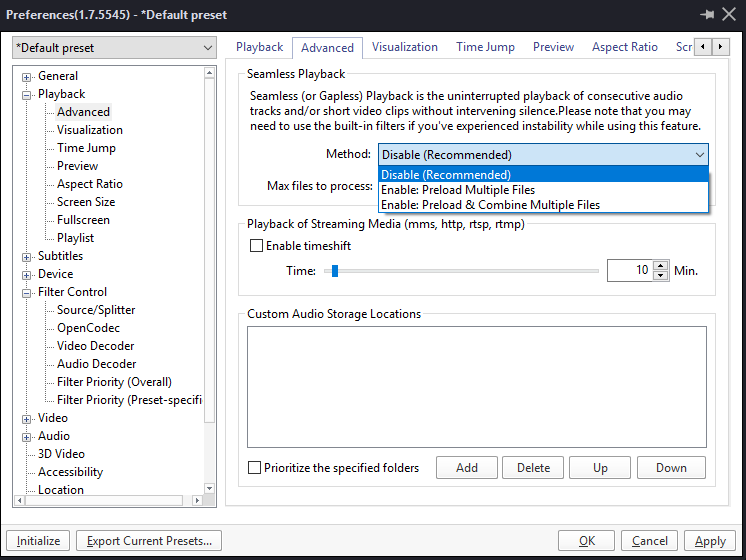

  12. Member Bernix's Avatar
    Apr 2016
    Europe
    Hi _Al_
    potplayer has same function but disabled default. To enable it go to preference(F5) then playback - advanced tab And here choose one of 2 methods. Default it is disabled (recommended)
    [Attachment 43988 - Click to enlarge]
    Bernix
