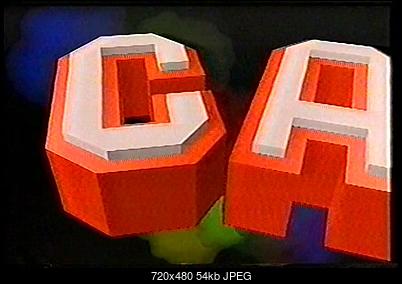

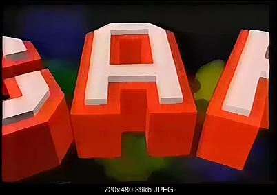

    These are pictures taken from a tape recorded in 1991, from TV.
    In these pictures it is possible to see two of the biggest problems I have been having.
    - The first one, is about the high noise in the red colors areas.
    Would be this a VCR problem? Capture card problem? Or maybe (probably) a problem because it was recorded from TV?
    Would be possible solve this by hardware? If not, how can I solve this by software?

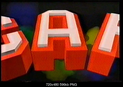

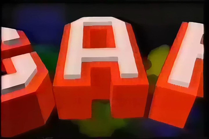

    - Second problem: the noises between the colors:
    (Click to enlarge)

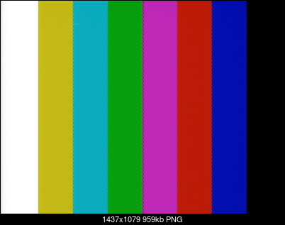

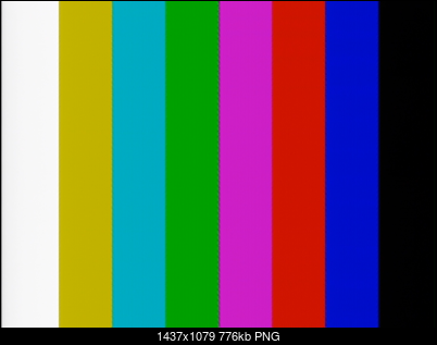

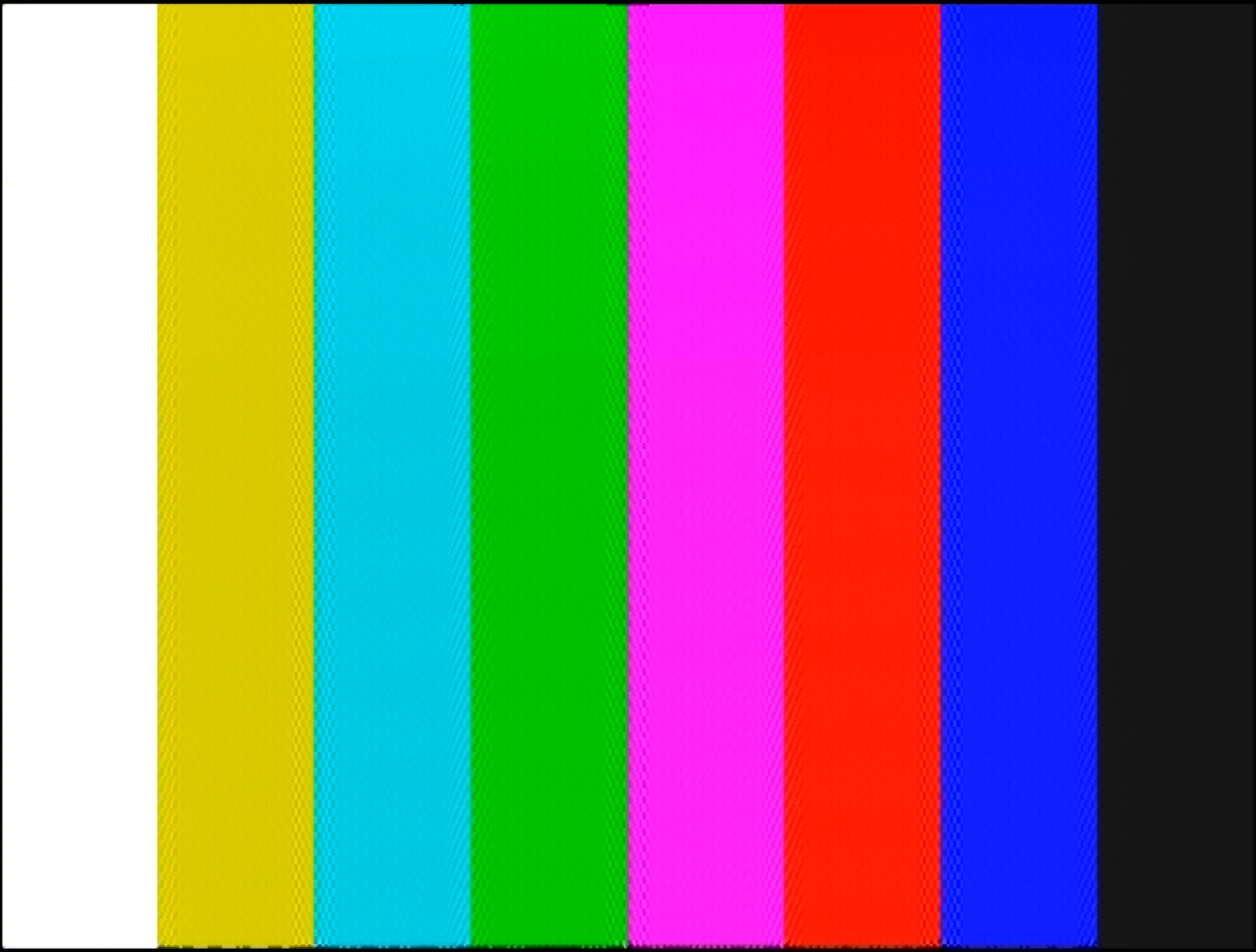

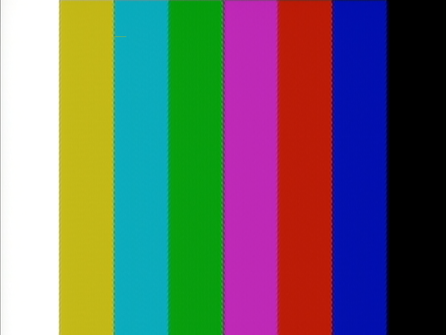

    I think this is not a problem with the VCR or the VHS tape. Because I am seeing a similar problem when my TBC (CTB-100) is generating the colorbars:
Name:	COLORBAR - VISUS.png
    (Click to enlarge)
    All images above were taken using a VisusTV PCI-E capture card.

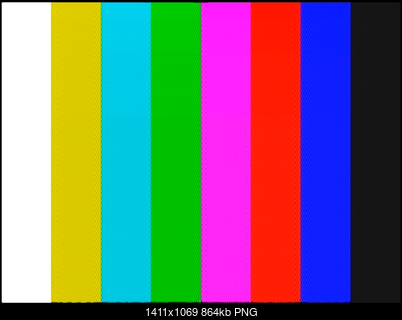

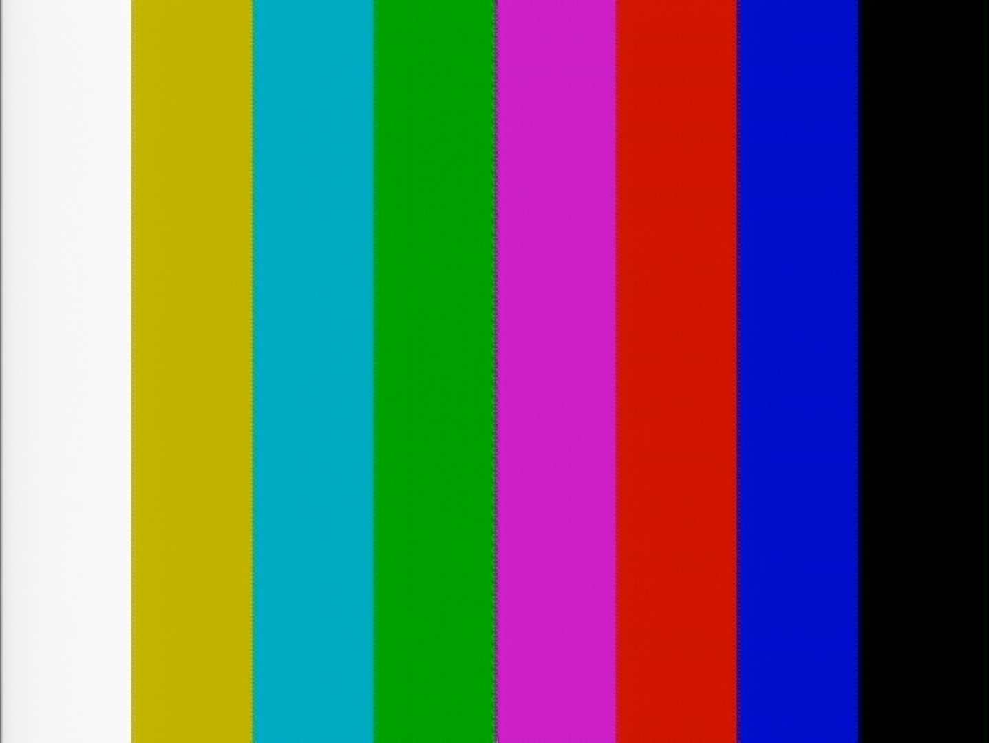

    Here is two other pictures of the same colorbars take using others capture cards I have:
    ENLTV PCI
Name:	COLORBAR - ENLTV.png
    EasyCap USB
Name:	COLORBAR - EASYCAP.png
    The same problem can be seen on all picture cards. More in ones, less in others.
    I was thinking that this would be a problem with the RCA cable, but I already tried to change the cables, and it did not solve the problem.
    I also tried to change the color system of the colorbars from PAL_M to NTSC, but the problem persists.
    Would this be a problem in the hardware? Or would this be a common feature from analog systems?
    Any ideas how I can solve these problems?

    Chroma noise is common in VHS recordings. It's a cheap consumer format, after all. You should be using a Y/C (s-video) output to minimize the problem and to eliminate dot crawl, which is evident at boundaries between colors. Some VCRs are better at reducing noise than others. Much more can be done in software, for example, using Avisynth.

  5. As was pointed out, VHS is an inherently low resolution, noisy system, especially for chroma (colors). The rolling dots at color edges are dot crawl artifacts -- incomplete separation of the chroma and luma from a composite source. You can greatly reduce them by resizing the frame to half width and then back up to full width. That doesn't hurt the underlying video because VHS is so low resolution to start with.
    The best way to deal with VHS is to use an S-VHS for playback, using the s-video output, and the deck's internal line TBC (or an external line TBC -- pass the signal through a Panasonic ES10 or ES15 DVD recorder). Capture with a lossless codec then filter in AviSynth. That will give you much cleaner results than your getting now. But it's a lot of work and costs a lot of money. There are many many threads here about this. There's no point in re-hashing it here.

  7. In AviSynth a sequence like :
    ImageSource("carrossel2.jpg")
    BilinearResize(width/2, height).Spline36Resize(width, height)
    will almost entirely eliminate the dot crawl:
    The bad aliasing at the bottom of the R will be fixed by better deinterlacing or an inverse telecine. The noise is best removed with a 3d noise filter like TemporalDegrain or MCTemporalDenoise. The oversharpening halos can be reduced with dehalo_alpha but that can be damaging to the video (usually not too bad with animation). Chroma can be sharpened with something like MergeChroma(awarpsharp2(depth=20)). And of course, there are all kinds of filters for brighness, contrast, saturation, hue, etc. Upload a video sample for more a more detailed filter chain.

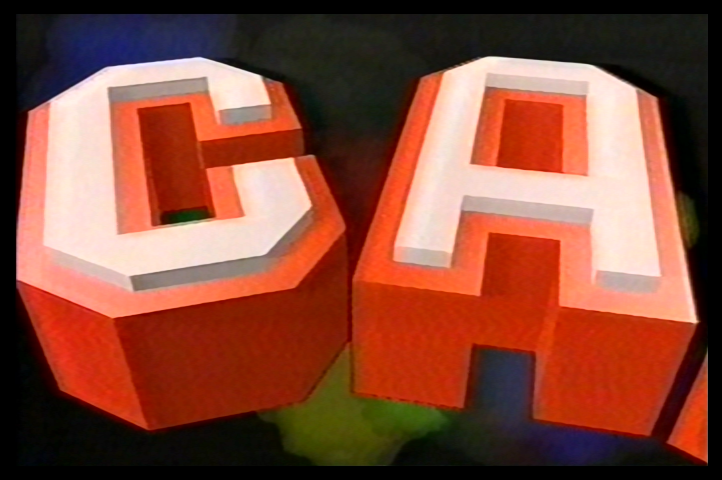

    This is way overdoing it (especially the noise reduction) but gives you some idea what can be done:
    But you'll really benefit from a line time base corrector during capture. This will greatly reduce all the horizontal jiggle -- which can't really be fixed after capture.

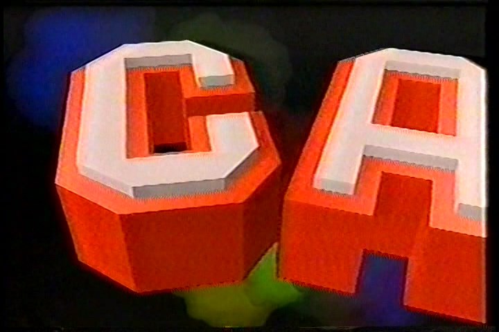

  8. I started with the last clip since it contains the titles in the earlier images. The video is from an interlaced camera and is best smart bobbed. I came up with this script:
    AviSource("forum 04.avi")
    AssumeTFF()
    ConvertToYV12(interlaced=true)
    BilinearResize(width/2, height) # resize frame to half width
    QTGMC(preset="fast", EZDenoise=1.0, DenoiseMC=true) # smart bob to 59.94 fps, mild noise reduction
    Dehalo_alpha(rx=2.0, ry=2.0)
    MergeChroma(awarpSharp(depth=5), aWarpSharp(depth=20)) # sharpen luma a little, chroma more
    TurnRight().nnedi3(dh=true).Turnleft() # restore frame to full width
    ChromaShift(l=-2) # shift colors up two lines
    Crop(4,20,-24,-8) # remove black/junk borders
    AddBorders(16,14,14,14) # restore borders with pure black, only necessary if you need the original frame size, eg. making a DVD
    Most of the dot craw removal comes from scaling the video to half width and then restoring it to full width. This doesn't hurt the clarity of the underlying video much because the source itself isn't very sharp horizontally.
    Since we need to bob to 59.94 fps we use QTGMC, the best deinterlacer. It has a built in motion compensated noise reduction feature, EZDenoise so I used that to reduce noise. 1.0 is very mild. Higher values give more noise reduction -- but you will lose detail more detail too. Other possibilities for noise reduction include MCTemporalDenoise() and TemporalDegrain(). They are all motion compensated and pretty slow.
    dehalo_alpha() can be very damaging. You may not want to use it. Watch for posterization artifacts in small areas. Like when a person's face is very small in the frame -- they'll start to look like mannequins.

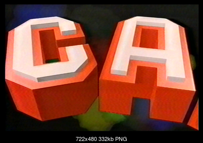

    I tested your script with the last clip (forum 04.avi), improved considerably the image quality. But I'm still having a lot of noise:
Name:	forum 04000501.png
    TemporalDegrain() is very good. I'm having a lot of improvements with it. But as you said, is pretty, pretty, pretty slow.
    Did you see the others samples? What about the forum 01.avi clip? What plugin would you indicate?
    All plugins that I'm using to improvement the forum 04.avi clip quality, is not making almost any improvement with the forum 01.avi clip.
