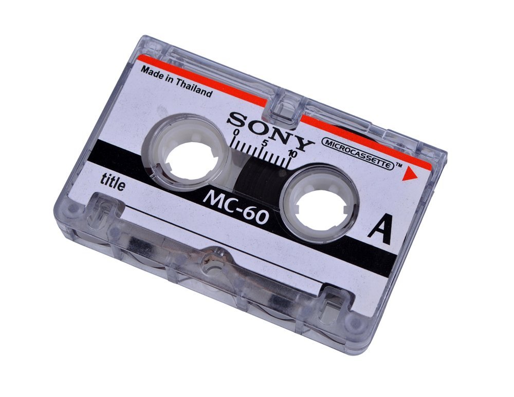

Does the tape look like this?
[Attachment 43967 - Click to enlarge]
If so, there should be no shortage of players around.
Unless the particular model you need had some sort of encryption or proprietary recording/playback method.
