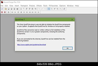

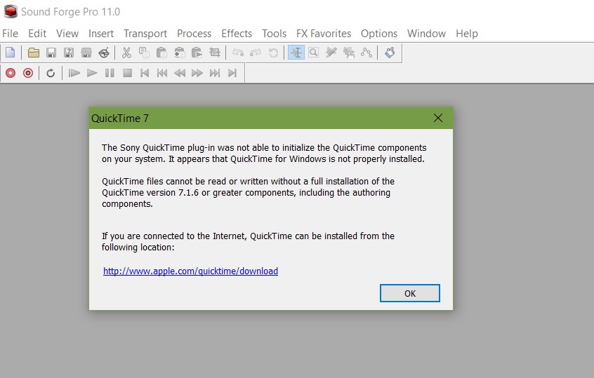

  1. I could have sworn I have opened an MPG or VOB file in Sound Forge in the past, but now I can't. I get this error message:
    The Sony QuickTime plug-in was not able to initialize the QuickTime components on your system. It appears that QuickTime for Windows is not properly installed.
    QuickTime files cannot be read or written without a full installation of the QuickTime version 7.1.6 or greater components, including the authoring components."
    And, when clicking Okay, another error message follows:
    Warning: An error occurred during the current operation.
    The file format plugin for the specified format was not properly initialized.
    I'm not quite sure what QuickTime have to do with MPG/VOB files, but nevertheless I did install it anyway, but to no avail.

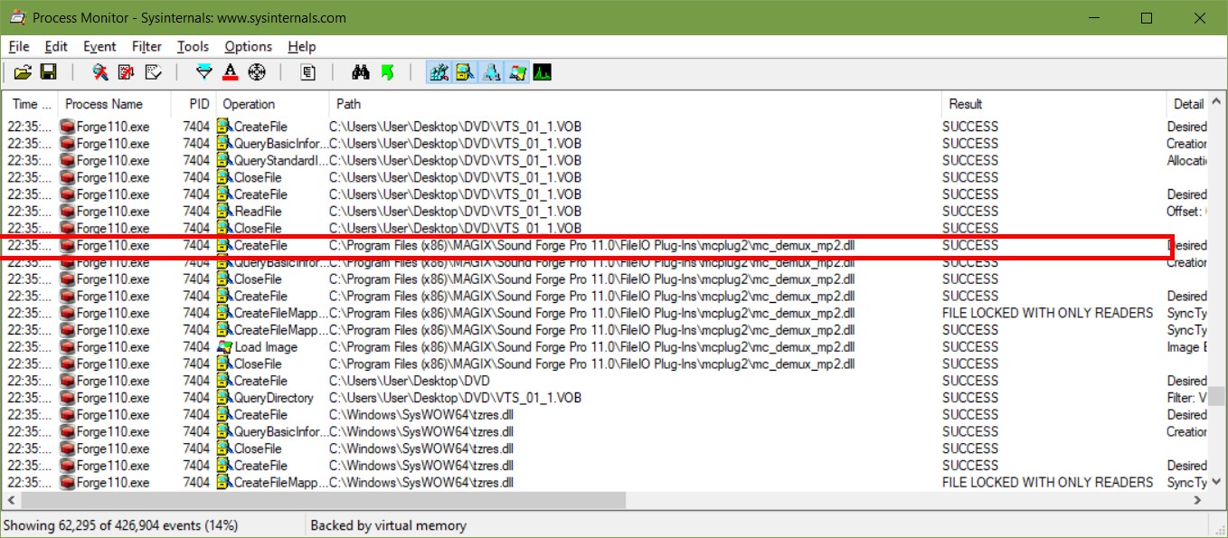

    I don't have Vegas installed and I can open vob files
    also in Process Monitor tool monitors in real-time all file system activity
    display after load Vob file access DLL in built in MPEG-2 plug-in folder:

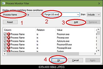

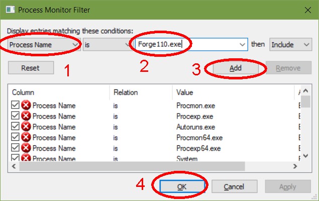

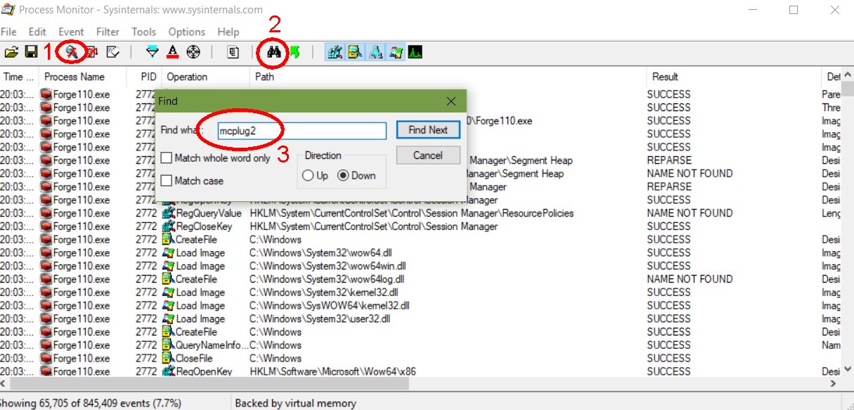

    Please first check if its load mpeg2 plugin correctly with Process Monitor : https://docs.microsoft.com/en-us/sysinternals/downloads/procmon
    run Process Monitor
    add filter to display log only from Sound Forge by:
    open and close Sound Forge

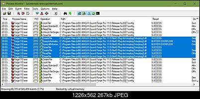

    stop capture log and find log line with mcplug2 folder:
    Do you see same success in log like me:
    capture log when you trying open vob in Sound Forge
    save and upload log file

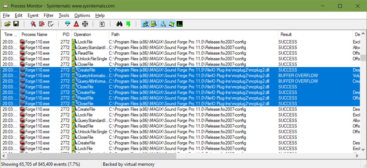

    I followed your instructions and this is what my log says about all instances of mcplug2.dll:
Name:	procmon mcplug2.dll.jpg
    So, "success" for the most part, but still it differs slightly from your log. Is anything about my log indicating something is not loading properly?
    I also searched the log for "mc_demux_mp2.dll", but there are no instances at all of that dll file.

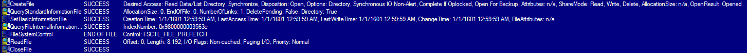

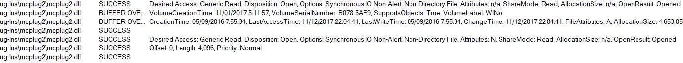

  12. Definitely something wrong with the file or have no access to file
    On my log AllocationSize:4,653,056 bytes, on you log is AllocationSize:0
    On my log CreationTime:05/09/2016, on you log is CreationTime:1/1/1601
    my log:
