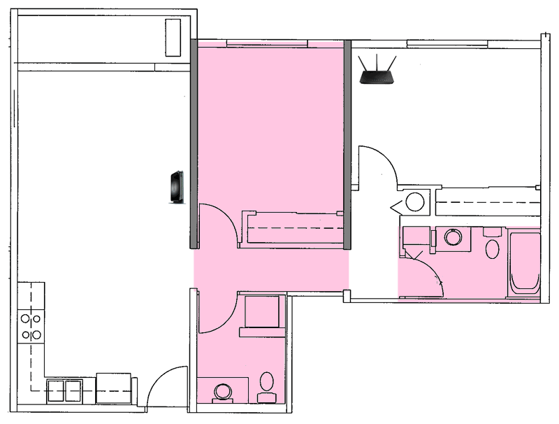

    Hello, I have some Wi-Fi troubles and hope somebody can give me some pointers. I live in a condo and I have an Asus RT-N66U router in a bedroom and a Netgear N750 WNDR4300 as an access point in the living room. They're connected by hard wire ethernet through a wiring compartment through the wall. I set them both to have the same SSID and WPA2 password. Wi-Fi signal is strong 4-5 bars everywhere in the house.
    Problem: When using Wi-Fi (2.4ghz band) on all my mobile devices, I notice the internet cuts out a lot. But I still see 5 bars of Wi-Fi. The webpages/social apps just refuses to load. I fix this by turning off Wi-Fi on the mobile device and turning it back on. It usually works for a few minutes until it happens again. This happens regardless of how many devices are using the Wi-Fi. Computers with hard wire ethernet work totally fine.
    I have drawn a map of what my setup is like:
    - Gray walls = concrete
    - Pink area = My Wi-Fi problems are concentrated in this area, it happens less in the rooms with the routers.
    [Attachment 43947 - Click to enlarge]
    I have little to no router setting advanced customizations.
    I have been upgrading the Asus stock firmware but it hasn't fixed the problems.
    I also tried power cycling everything and switching to the least-used channel.
    I'm wondering if it's because the pink area is between the 2 routers, and it's trying to decide which router's network to connect to?
    Any help would be greatly appreciated! Thank you so much!

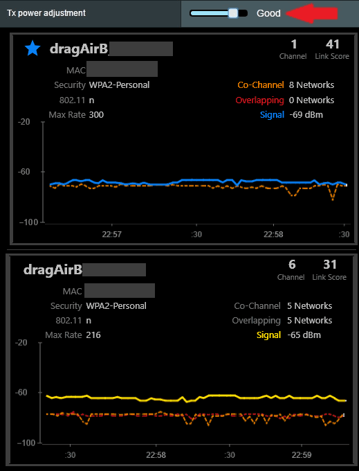

    Thank you for your in-depth replies. I downloaded inSSIDer and checked Wi-Fi channels. My apartment has plenty of neighbor networks. I changed my routers to 2 different channels (as seen in my screenshot below) that are the least occupied. As you can see, my signal isn't the best due to concrete walls. I seem to still get occasional drop outs but will continue to monitor it.
    On both routers, Tx power is set to 100%. What would you recommend to lower it to? I am only able to set it in 25% increments.
    Also, do you have a recommendation of the sweet spot to place one general router? I've tried before but due to power outlet and furniture arrangements, it was easier to setup an AP on opposite end of the house.
    [Attachment 43959 - Click to enlarge]
    The blue star network is my Netgear AP which my computer with inSSIDer is closer to. The other network listed is the main Asus router.
    The Netgear AP is set to use Wireless Access Point mode (I'm guessing that is the same as bridge mode?) with fixed IP address.
    I have tried the 5ghz band networks but their range is not that good and I'm usually disconnected when I leave the room the routers are in.
    Thank you again for your help! Much appreciated.
  5. For signal propagation methods similar to ray tracing can be used ( for example https://www.remcom.com/wireless-insite-em-propagation-software/ ; http://www.cwins.wpi.edu/projects/ray-tracing.html etc) however i'm not aware of any open source tool to perform such function (and ordinary graphical ray tracing will not work due significant difference in wavelengths).
    Afraid that you have no option other than empirical and some intuitive approach. In longer version i've described some problems and why too strong signal can be as bad as too weak signal - briefly i can say this is about amplifier linearity, overall noise level and competition between different transmitters that must share same spectrum - imagine two screaming kids in one room - at some point there is nothing except high noise level.
    From my experience for single AP best location looks like corridor nearby bathroom. You can also use single AP and with help of RF cable move antenna to required rooms (i know how this sound but at a cos of loosing MIMO you may gain stable connection with sufficient bitrate) - https://www.amazon.com/Antenna-RP-SMA-Extension-Cable-Router/dp/B005C8AYG0 - it doesn't look expensive, perhaps you can find it in proper colour that will fit in your expectations - cable attenuation may help in your case - IMHO definitely worth to try.
    You can also try trick with different antenna polarization (place AP's with antenna orthogonally) - this should separate both source by approx 20dB however in environment where reflection dominating it may be not visible (but it may improve overall link as probably your mobile devices working in non-optimal positions anyway) - RF is not trivial things - lot of people thinks about RF like technology that just work out of the box where reality is very far from such expectation - RF works well in very narrow scenarios - in most of real life scenarios plenty of effort must be invested to get satisfactory results.
    You just need to try various settings (reducing by 50% should cut range by 4 times), keeping power as low as possible (your network performance) is always recommended (even to protect pollution of the EM spectrum).
  6. OK, a problem on a system with many components. First step is to simplify the system. AP's are often problematic, disconnect and power off the AP and test with router only. One wifi transmitter and signal to diagnose. For testing period, stay in the same room initially, second round go to alternate room, where AP is currently located. If feasible disable all other internet usage while testing. Not refrain from, DISABLE, as in power off the device. Not it's not a likely cause but if other devices are turned off, then they damn sure are NOT the problem.
    Testing - what is the shortest period you have observed with no issues, and what is the longest? Day / Night a factor? Highly variable? Use standard time measurements, a rough guess is OK. Take the longest observed interval, double or triple it if feasible. Meaning use wifi with router ONLY, AP disconnected and powered off. This is to insure a true solution has been discovered.
    The thick grey walls, are they by any chance stucco covered? Concrete not usually a problem, but stucco is. This is usually installed with a sort of chicken-wire backing and that crap is murder on wifi signal.
    If possible, move router closer to, facing, or actually in the hallway connecting the two main areas. This is ONLY for AFTER initial test to determine if AP is the problem or not.
    Signal strength being too strong is not a problem I have ever had on any installation. Signal interference, blockage from stucco, metal, or really old wood, faulty equipment, AP issues sure, but signal too strong? I would spend zero time on this, and I get paid to fix this stuff.

  10. Member Sakuya's Avatar
    Dec 2002
    The walls are not stucco covered. The shortest period when I have no issues while using the 2.4ghz band is 5 minutes. So far I haven't had any issues while using the 5ghz band and I have been using it for 10-15 minutes.
    Thanks for everyone's help. I'll try to test the best location for the router. For now I'll be using the 5ghz network.
