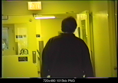

  1. Click image for larger version

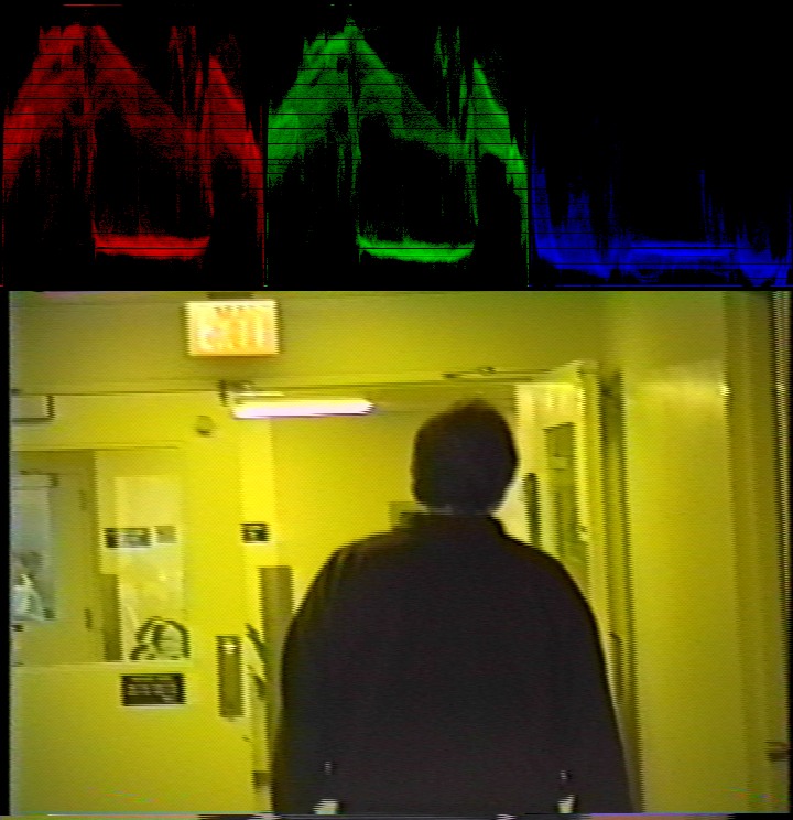

    I can't seem to improve the image.

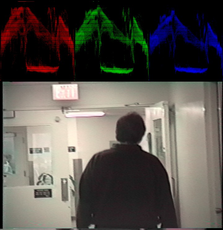

  10. The blue channel is hosed.
    [Attachment 43948 - Click to enlarge]
    One thing to try, is faking it:
    [Attachment 43949 - Click to enlarge]
    In Avisynth,
    MergeRGB(
    \   ShowRed,
    \   ShowGreen,
    \   Grayscale.ShowBlue )
    Still leaves lots of secondary issues - blown out highlights, fringing, shading. Good luck with all that.

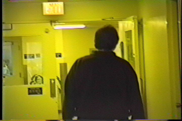

  11. Here is the original.
    Doesn't that just make the image black and white?
  12. Originally Posted by Hypersonic1 View Post
    Nope. You copy grayscale (luminance) information to the blue channel and leave the other two channels alone. The result is posted above and while it's not pretty, it's not grayscale. I show the AviSynth script I used, but the same thing can be done with many other programs.

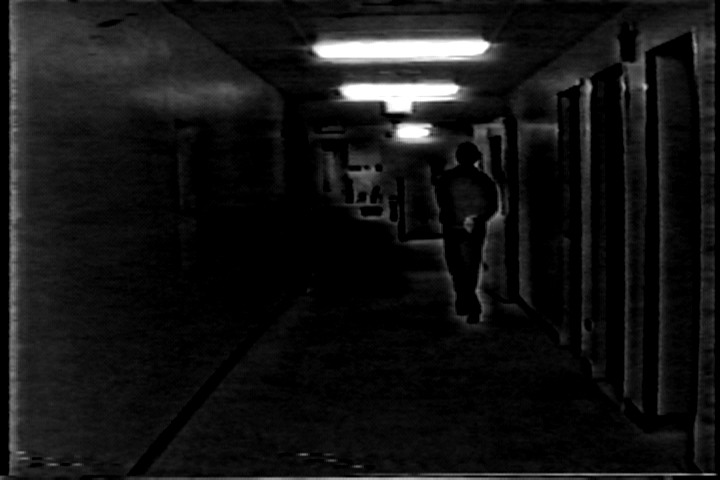

    BTW here's the blue channel alone - overloaded by the fluorescent lights (I guess) and beyond color correction:
    [Attachment 43954 - Click to enlarge]

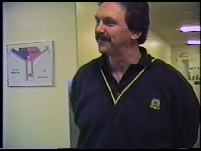

    Since I work almost entirely with black and white sources, I've had next to no experience with the AviSynth filter GamMac. But it does seem to make a big improvement and I'm sure it can be tweaked to give better results. Notice the huge gamma boost to the blues.
    ConvertToRGB24()
    GamMac()
    ConvertToYV12()

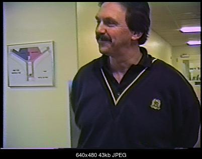

  15. From the earlier mp4 file. The guy's a bit too purple, over saturated, and needs a little more adjustment...
    brights = ColorYUV(off_u=61, off_v=-5)
    darks = ColorYUV(off_v=-2)
    bmask = ColorYUV(gain_y=100, off_y=-40, gamma_y=50).GreyScale()
    Overlay(darks, brights, mask=bmask)
  16. I initially assumed the walls were white but that made the guy look even more purple. So I used the sign on the wall as my white reference.

    If you want something close to jagabo's result use the channel mixer in PP . I just "eyeballed" this but effect => channel mixer (RR 105, GG 100, BR 25, BG 25, BB 120) . Adjust it how you want
    Or you can do the channel swap similar to RR42's approach in AE . You can do a weighted channel repair (you might not want 50-50) using shift channels , to reconstruct the B from the R and G instead of greyscaling it e.g. blue to red, blue to green, original blue . To toggle just adjust opacity layers . (or you still have the option to greyscale the blue). Same thing in avisynth could be done using merge() with the weights, and mergergb()
    A third approach is to use the color cast removal, eye dropper technique . Similar to photoshop where you pick a white, middle grey, and black point and it will shift the RGB curves. You can do that in color finesse for example in AE . CC Color Neutralizer in AE is basically very similar
    A fourth is to selectively desaturate a range . For example the hue/saturation filter affecting "yellows"
    You can mix and match the approaches to maybe get slightly better results . But the key thing to remember is you will never get something looking completely normal because the blue channel is crushed and missing so much information
