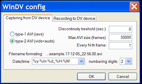

    Ive been trying different Max AVI size but I still get too large files. I've attached a screenshot of my settings. Could someone tell me how I can do this? Thanks

    Thanks for the reply. I read that post but was hoping for tips on what mistake I'm making in my settings. Would it be the number in Max Avi size?

    My point is.....if WinDV is involved.....you are going to get massive file sizes. I believe the only thing "Max AVI Size" does is break up your massive data transfer into huge smaller pieces.
    I'm not sure what you are doing but, if you are assuming that this setting will make a 1 hour/13GB data transfer into a 1 hour "fewer Gigabyte" file size......that's not what it was meant to do.

    No. WinDV can create single files that are larger than 2 gb.
    You can do the math on that number since 50000 frames will give you 28 minutes.
    28 minutes is still approx. 6 gb so if you only getting 2 gb chunks it is not the software. Are you by any chance recording to a drive that is formatted as Fat16 ?

    i use 999,999 as max avi size to record a tape in one file.
  6. DV is about 13.5 GB/hr. An hour of NTSC video is 107,892 frames (29.97 frames per second * 60 seconds * 60 minutes). If you want 2 GB files: 107,892 * 2 / 13.5 = 15,984 frames.

    Appreciate your replies. I have ca 250 mini dvs of live concerts. Mostly just a camera stuck up as we played. I'd like to get it off the tapes before they deteriorate and when there's time pick out some memorable parts. I'd like to at least keep the original quality since it doesn't look as good as what I'm used to seeing on todays digital camera. I guess I'll have to invest in a few more hard drives. I've got 1.3 TB left on my drives now. My problem was the first try I got very many small files of a minute or so (even though it was the same concert) and then when I tried to adjust the settings it kept going over 4gb. By the way the original mini-dvs are PAL. Thanks
  8. 4 GB of PAL DV will be about 26,666 frames. 2 GB will be half that many frames.

    Could be you are hitting the 2GB/4GB mark because of the software, or because of the filesystem. If your drives are FAT32, that will limit them (change to NTFS). For contiguous single clips, use something like Scenalizer Live to transfer.
    That did the trick. By changing the discontinuity threshold to 0, which I read elsewhere on this forum and using 13,333 I got around 1gb sizes. I've gotten some good help on this forum in my task. Thanks
