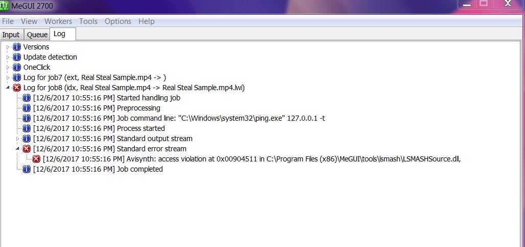

  3. Originally Posted by Bernix View Post
    According to your settings (Log) you are converting 25 to 50 if I'm not wrong. It can be easily done if source is interlaced use deinterlace filter with doubling frame rate. 25 -> 50 is O.K. Not sure about 25 - > 60 (IMHO bad idea)
    Bernix
    Yes m doubling frame rates cause 60fps build large file size and how can i double frame rates with your method can you explain more ?

  7. Image
    [Attachment 43925 - Click to enlarge]
    I am trying one click method and getting this WTH.
  8. Originally Posted by Bernix View Post
    I understand you. It has to be very frustrating. Only advice I can give you, if not solved in meaningful time, switch to other similar software. Most similar seems to me Hybrid. It supports Avisynth or Vapoursynth. Not both at once. And deinterlace your source with bob (doubling frame rate) will make your file 50 unique frames per seconds. It has also QTGMC method, which is here on videohelp prized for its quality. And Hybrid is massive download, because contains everything in setup file. Containing Tsmuxer avisynth and vapoursynth etc.
    I hope you solve your situation to your satisfaction. BTW have you Admin rights? Can't this be problem with MeGUI? But probably not.
    Yes i am the administrator.
    and this Hybrid is a huge one mm i think i should give it a try.

  16. Originally Posted by Bernix View Post
    Bernix
    Finally i managed to fix the issue in MeGUI by myself.
    the thing i did
    1- uninstalled avisynth, deleted MEGUI
    2-installed avisynth again, install MatsrokeSplitter.exe
    3- Extracted MEGUI open it and i do not update it and in the settings i unchecked the Auto Update too.
    4. save and closed MEGUI.
    5. copy paste some additional plugins given by SPIRTON in the AviSynth Plugin folder.
    6. open MEGUI again created the script again and set all settings according to SPIRTON.
    7- and done.
    last thing it asked to update x264 2851(komisar) and mkvmerger from its server when i en-queued, updated it and all set.
    I think the problem was in HaliSplitter update in MeGUI this time I manually installed MatsrokaSplitter and did not update MeGUI's own HaliSplitter Update.
    I have encoded 2 videos perfectly and the green line is gone...............
    Any ways thanks to all of you guys for guiding me.
