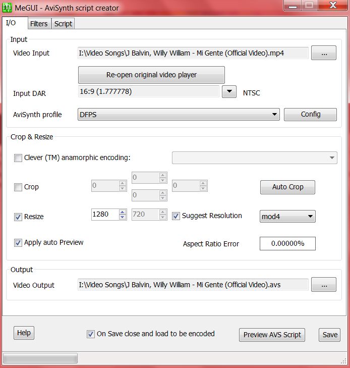

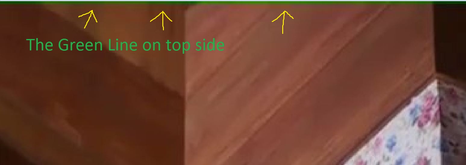

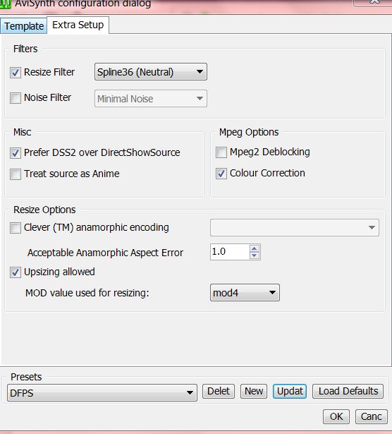

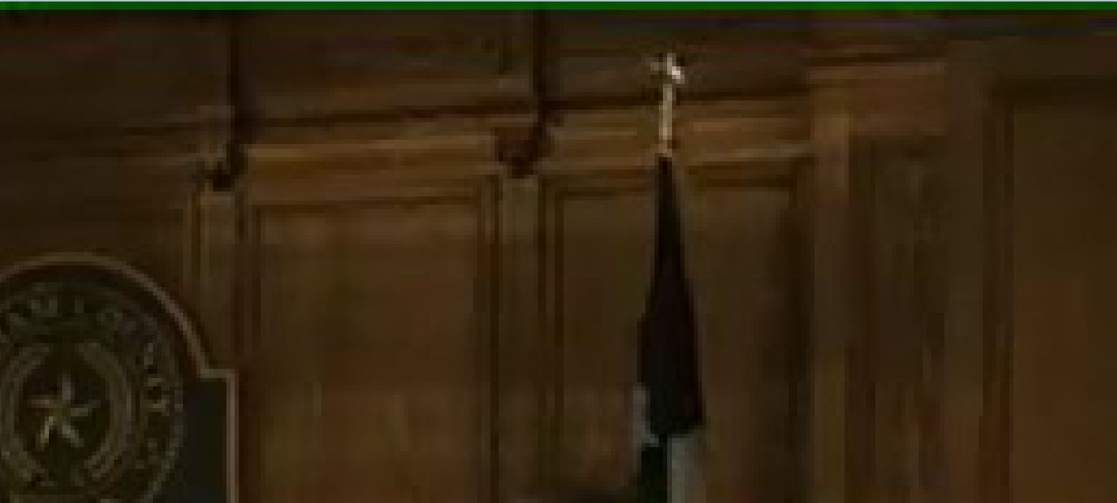

    I am having a weird issue in encoding, i am encoding videos with MeGui 2774 and Avisynth script problem is every video i encode is showing a thin transparent horizontal green line on top of my encoded videos
    I am attaching screenshots of video preview and script settings:

    I have tried copping from top side but it didn't work.
    any one have an idea whats going on, it never happened in previous version of MeGui.

    I would suggest you turn off Color Correction unless you intend to upscale SD content to HD. Probably has nothing to do with your green line problem, it's just another problem.
    Maybe showing your script might help.
    already tried Bro still same result.

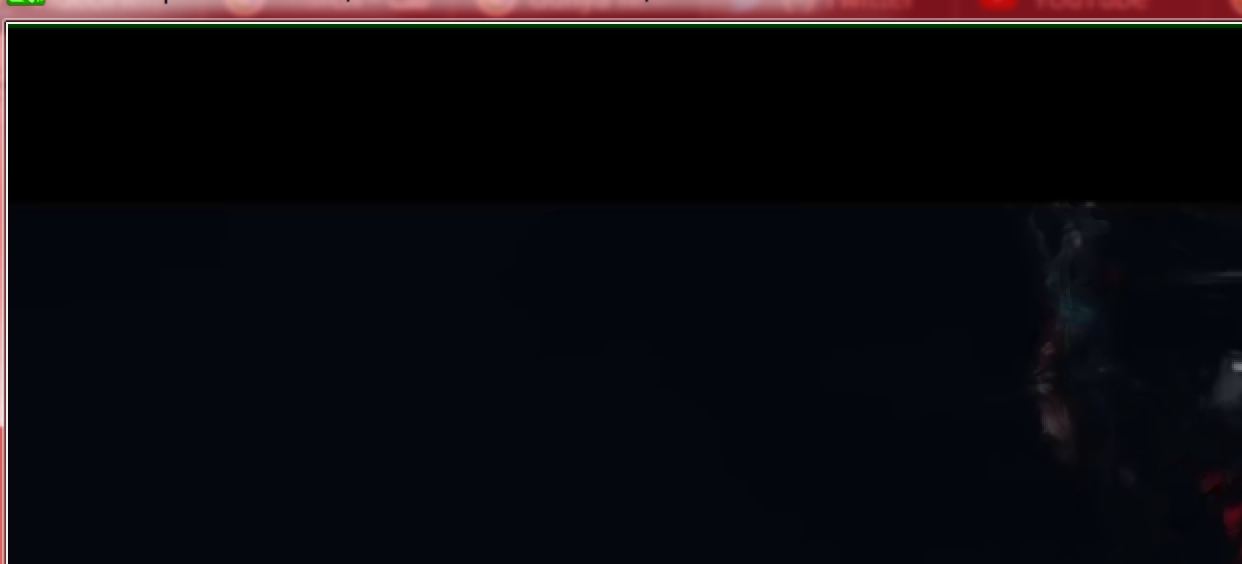

  13. i tweaked k lite codec preferred splitters and set avisynth to LAV after that i am having error of can't load mead stream

    I just encoded this sample video of a movie and the line is still appearing on top of it as u can see...
    [Attachment 43912 - Click to enlarge]
