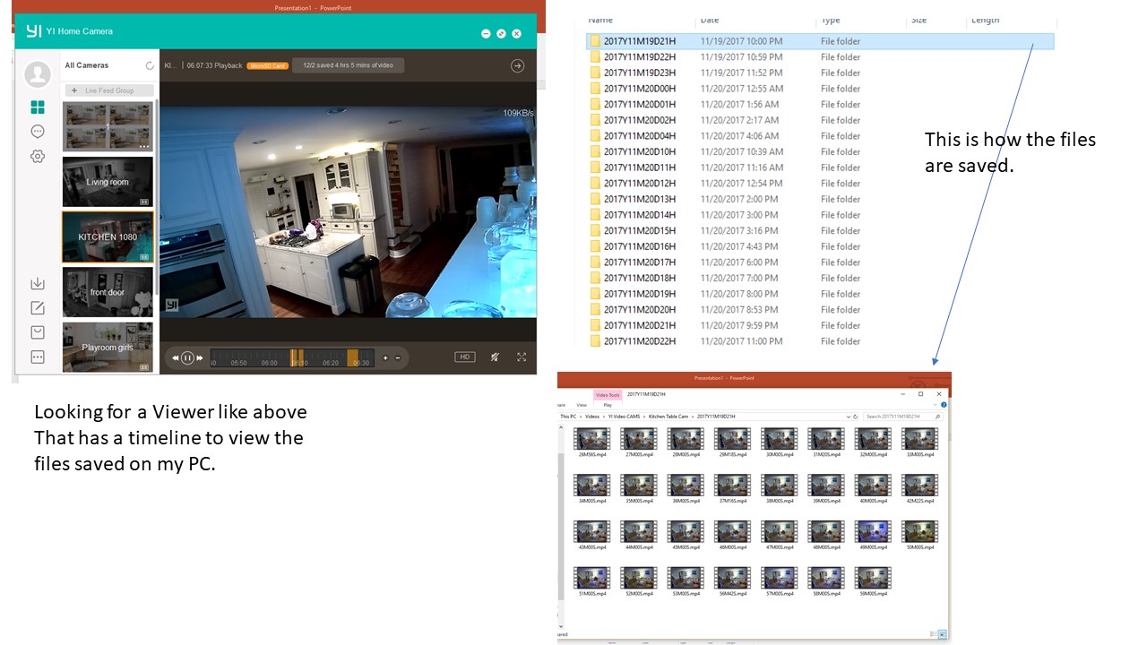

    Greetings, I was wondering if someone can suggest a Player/ Program that can play copied .mp4s from my Yi Home Cameras that are saved on my PC.
    BACKGROUND:
    I copy and paste from the miniSD cards that are in the Yi Home Cameras to my PC.
    OBJECTIVE:
    I want to be able to view these .mp4s on a player with a timeline vice individually selecting each video one at a time.
    YI provides a good player on your phone and PC, BUT, it only reads/plays what is currently on the cam's internal SD card. It DOES NOT play files saved on the computer.
    YI does not have a player that plays cam footage located on your desktop.
    Any Suggestions on a player/program? Thanks in advance for any suggestions!!!

    Bernix, Thanks so much for the response. Here is the Mediainfo. Below that is a picture of what I desire. IT is the Yi viewer that only works on the miniSD that is in the Cams, not for files on saved on the PC.

    Thanks All, VLC works pretty well. Does anyone know if you can add a date stamp on the video the Date Created? It would be nice to know when the footage was taken while watching it.
    All the 1 minute files are saved in a folder like this \2017Y11M19D22H then each file is saved like this "08M04S.mp4" Thus, each folder is for an hour of the day and each file is saved as the Minute and Seconds.
