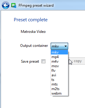

    But now, i got another question for you, as the wizard made me think of that :
    Name:  FFmpeg preset wizard.png
    In the preset wizard, container list is quite long
    I'm thinking that sometimes, I could maybe use remux with some of those containers, not available in the mux tab.
    So my question : how difficult would it be to "allow" those containers in the mux tab ? Would it be complicated to implement ?
    Nothing serious or urgent here, but it could be useful, so i'm asking
    Thanks again !
    Nov 2017
    Madrid, Spain
    Great everything seems to work fine.
    Adding new formats is actually an easy task, it's just I like to keep things "simple" for non-advanced users, since adding more containers increases the chance of mux failure due to codec/container incompatiblity.
    Anyway I think it's fine to add more containers and let the users play with everything. Error information can be found on the Batch log file.
    I will add them in the next release, coming soon

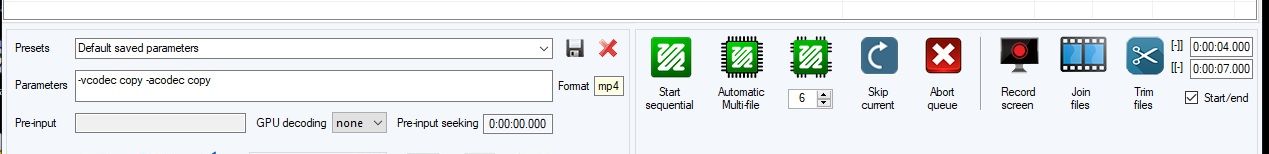

    I didn't see a way to post a new thread, so my apologies for introducing a new question.
    I would like to know how to remove the first x seconds of a video and that last x seconds of a video from a batch of videos; without losing quality (re-encoding). I have managed to remove the first x seconds with the parms:
    -ss 10 -vcodec copy -acodec copy
    Since the videos in batch are of varible length, how do I remove the last x seconds of the video? Is it one step process or 2-step?
    If someone could assist me with what I need to put into the FFmpeg Batch for Windows do take off x seconds from the beginning and x seconds from the end without re-encoding, that would be great. I know how to do this with just FFmpeg and FFProbe manually on one file at a time but not within this Batch program (which I like as I can drag and drop multiple files).
    Nov 2017
    Madrid, Spain
    Hi, batch trimming from the beginning is possible, but from the beginning and the end such feature is not implemented yet in FFmpeg Batch.
    You could do it only one by one, with the trim video button setting duration manually.
    For next beta or release I could add some sort of feature like the one you need.
    Just keep in mind that trimming without re-encoding comes with some potential issues. Any trimming not matching the video keyframe interval can lead to unexpected results, like black frames or video corruption.

    Hi, I have added a "Start/end" checkbox for the trimming feature, you can download it here and give it a try (overwrite your existing executable file on your installation folder:
    https://drive.upm.es/index.php/s/XfVMRfVoTo0SmMd/download

    Works perfect! I tried it on several batches of 10 or more videos of varying lengths. (Version 1.6.3.1)
    I used settings in the attached image.
    Thank you!

    Great. You can also just use '-c copy' as parameter for stream copy.

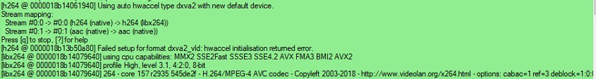

  29. Hi,
    in the meantime i have seen that h264_nvenc hat not implemented the crf Option, i have tried -qp Option, but that gives not the same Result as -crf (some files will be larger as the original)
    So i tried libx264 with -crf Option but here the GPU encoding isnīt working.
    With libx264 i get the following error
    [Attachment 47970 - Click to enlarge]
    With h264_nvenc i get the same error but without using cpu capabilities
    [Attachment 47969 - Click to enlarge]
    How can i use GPU encoding with libx264? Without GPU the encoding needs the double time.
    I have a nvidia Quadro m1200 (GM107 Maxwell)
  30. Member
    Nov 2017
    Madrid, Spain
    Hi,
    As you noticed, there is not a true constant rate factor mode in nvidia encoder, so -qp is the closest to that option. The gpu encoding is much faster but at a cost of being more limited in encoding options and less efficient in quality/size ratio. You can't have speed, quality and limited file size at the same time, and since gpu encoding is usually intended for real-time applications like streaming, speed is critical. That's why achieving a given crf (-qp) results in big files.
    Libx264 uses only CPU, no way to use gpu with it. It provides better image quality at the same file size, with speed being the limiting factor.
