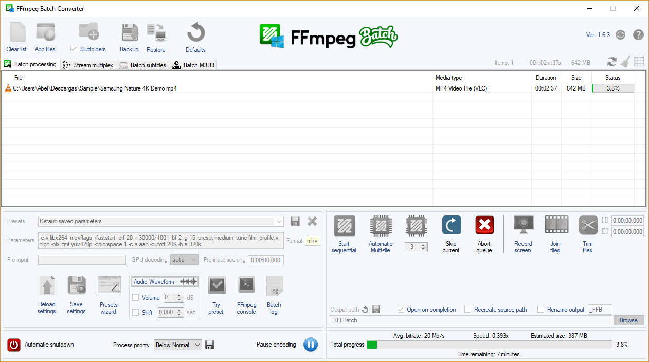

    Hi,
    I haven't been able to reproduce first issue with a couple of 4k videos 23.976 or 29.97 fps, using ffmpeg 4.1 build and both 30/60 fps presets.
    [Attachment 47373 - Click to enlarge]
    [Attachment 47374 - Click to enlarge]
    Maybe your video has something different, a sample could be useful.

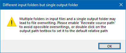

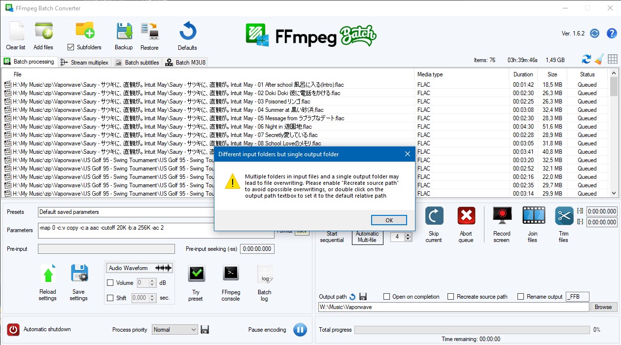

  25. Hello. I was looking for a program to transcode audio files, and for my case this is the best thing yet.
    However, while trying to transcode multiple files from different folders, the app would not let me start the job. There just was a warning that files may get overwritten, but the files were all with unique names, and there was no way to ignore the warning, even with a -y option in the parameter field.
    Is there a way to dismiss the folder warning and continue with the transcode anyway?
    I have attached screenshots of the warning.
    [Attachment 47412 - Click to enlarge]
    [Attachment 47413 - Click to enlarge]
  26. Member
    Nov 2017
    Madrid, Spain

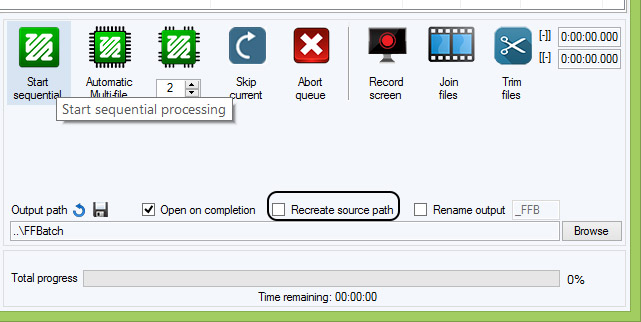

    Hi, just click on the checkmarck "Recreate source path" and it will continue.
    All files will be saved to the output folder, but with their own source folder first.
    [Attachment 47419 - Click to enlarge]
