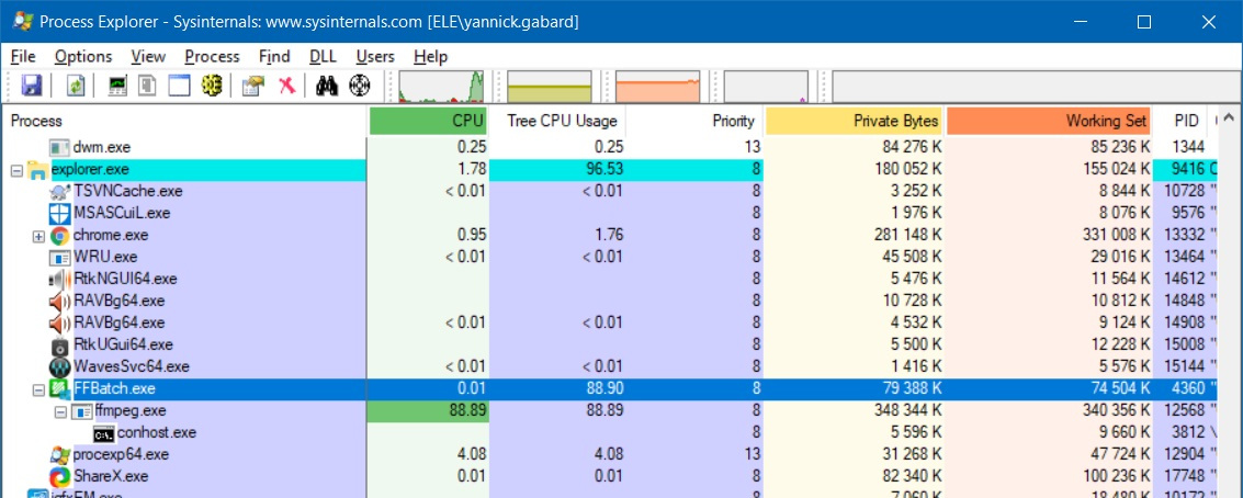

    Hi Eibol, here is how I tested the process priority.
    Using SysInternals Process Explorer
    https://docs.microsoft.com/en-us/sysinternals/downloads/process-explorer
    Click right on Columns header, "Select columns..."
    Process performance Tab, adding "Base priority"
    Into FFBatch I selected Idle
    [Attachment 46491 - Click to enlarge]
    But into process explorer ffmpeg processes keep at Priority 8 (Normal). Dunno what I do wrong but on my side, processes priority are not altered.
    [Attachment 46492 - Click to enlarge]

    Hi again, thanks for your testing.
    I have been checking with the same tool and now it seems to work fine, ffmpeg process changes to priority 4. The beta version you were trying just changed priority once process had started, it still needed some work. Just note that only ffmpeg processes are affected by priority change since they do the real work, the main ffbatch interface process is not affected.

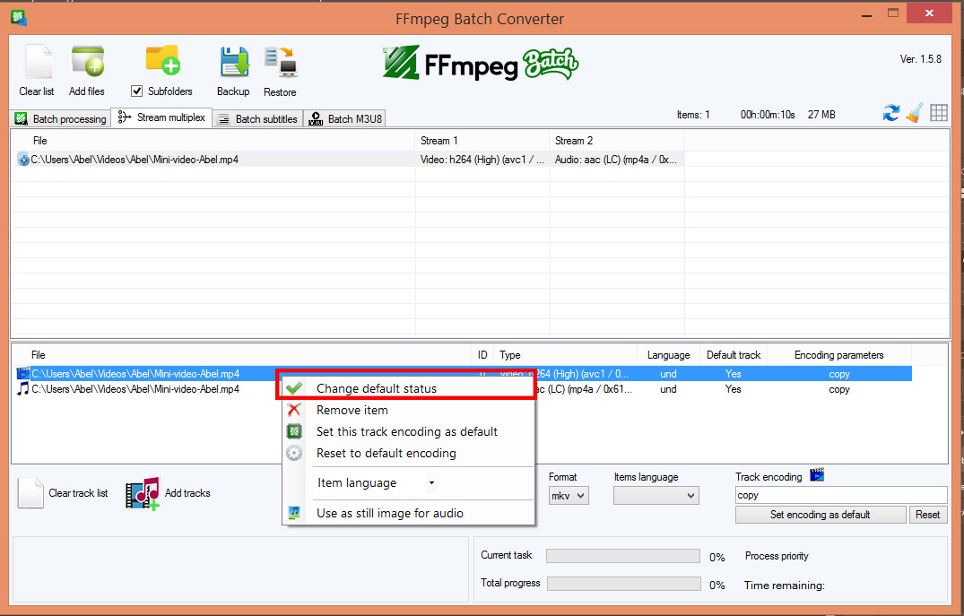

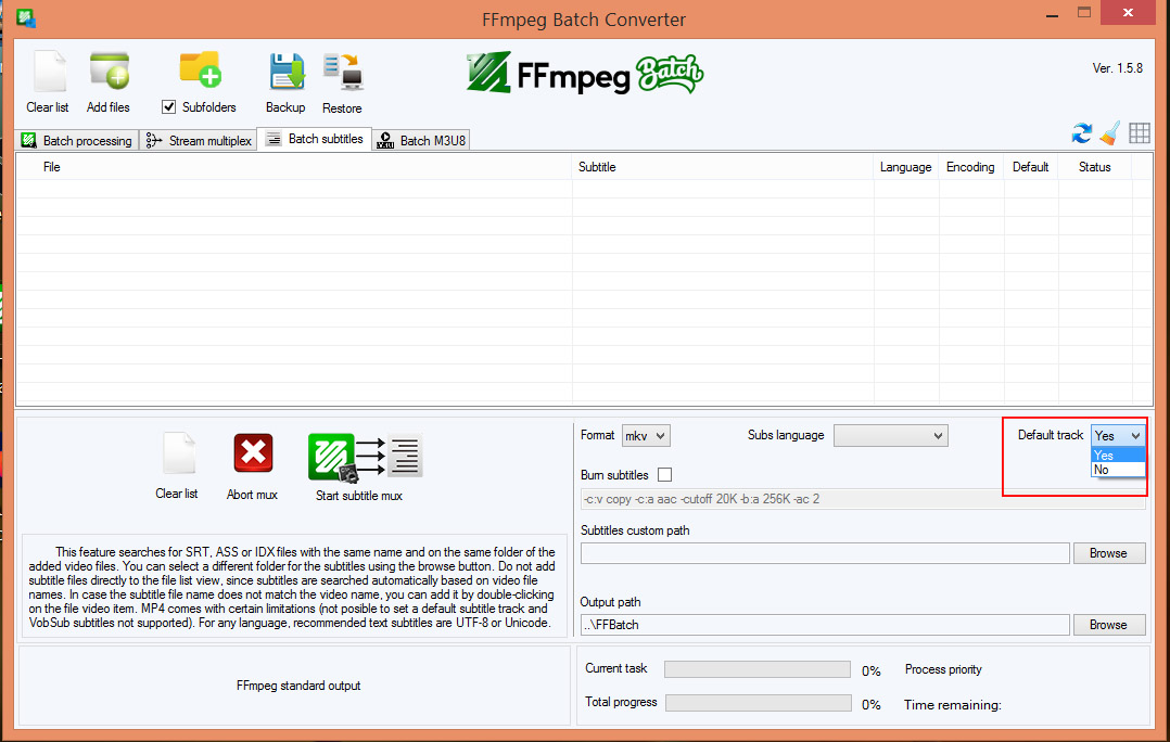

  6. Is there any way to set subtitles as forced with FFMpeg? (so avoiding to use MKVToolnix for the purpose)
    Nov 2017
    Madrid, Spain
    I think you mean "default track", that is, subtitle is shown on default playback, you don't need to select the subtitle.
    FFmpeg parameter for this is 'disposition', like in this example:
    ffmpeg -i in.mp4 -i in.srt -c copy -disposition:s:0 default out.mkv
    With FFmpeg Batch for Windows you can do it in Stream Multiplex right-click menu (Change default status), or in Batch Subtitles tab in the "Default track" dropdown menu.

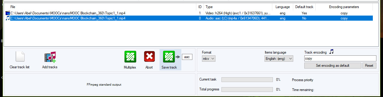

    New version 1.6.0.
    - Added feature in Multiplex tab for saving individual streams in one click.
    - Restored multi-file processing old feature that allows to specify the number or simultaneous files.
    - Minor bugfixes.
