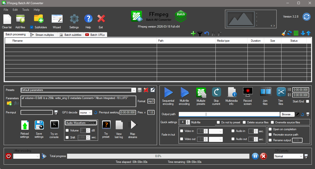

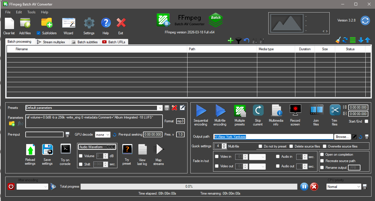

  8. I like to use night/dark mode on all my apps where possible. I noticed an issue with night mode on FFmpeg Batch. When you are in night mode the lettering in the "Output Path" field changes from black to white but the background remains white, so you can't just glance at it to see what your path is.
    You can highlight it. and then the white lettering shows against the blue highlight, but I think the background should change to dark so that the path is visible all the time.
    I've attached two screen grabs to illustrate what I mean.
    I don't know how long this has been happening, but I first tried night mode about 3 versions ago. I just assumed it might get remedied when the program was updated. I am on the latest version now, 3.2.8
    BTW, I love this program and I use the heck out of it. Thank you.

    Thanks for the bug report, it will be fixed on next release. This patched exe should fix it too.
    Patched_ffBatch_328
    Cheers

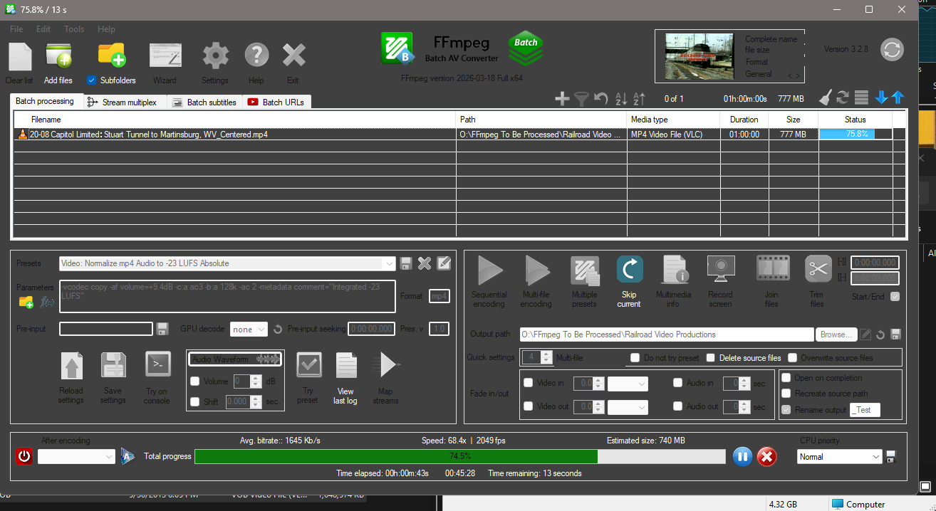

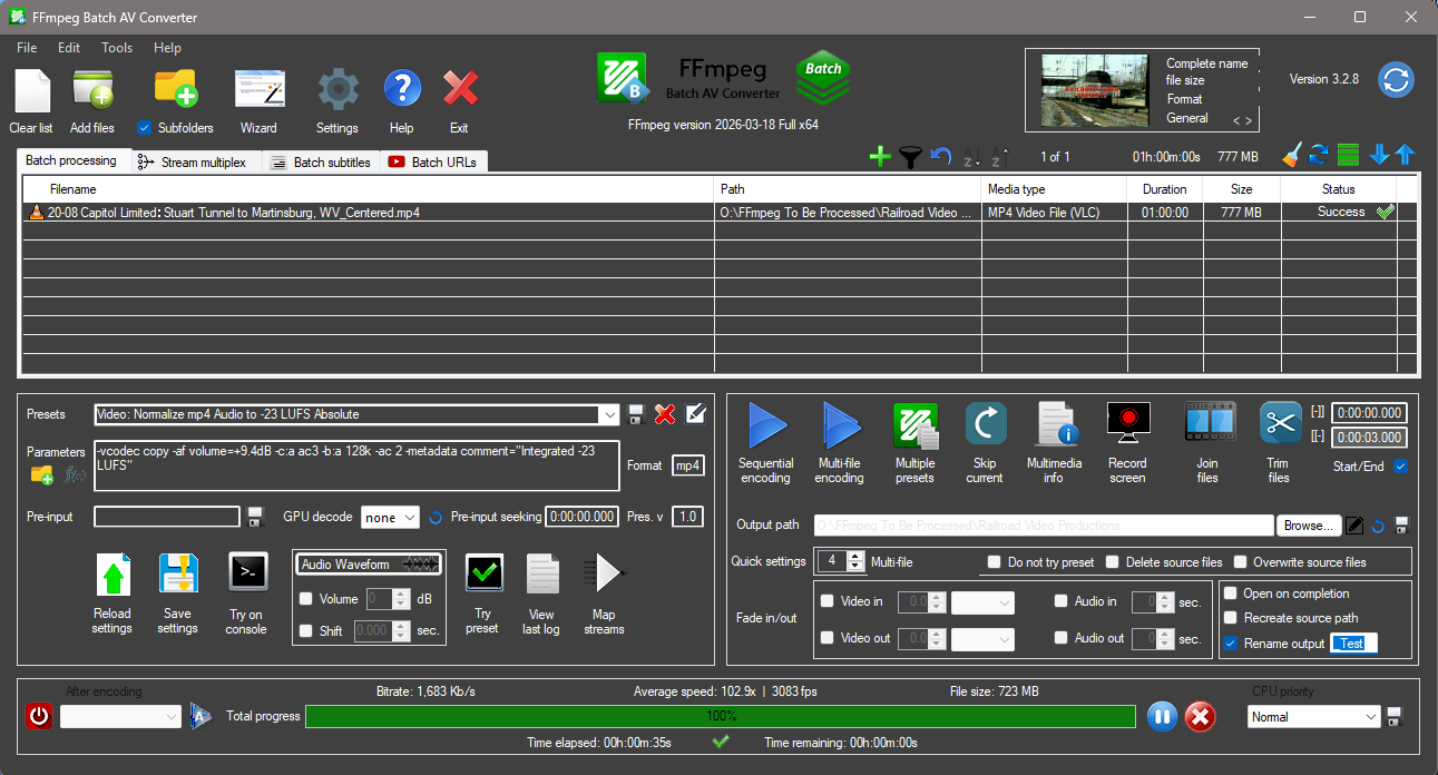

    Just to let you know, I tried the patch but it is still exhibiting strange behavior. When it is idle it does not show up in the "Output Path" but it does when you start processing. It appears to have the same situation in the "Rename Output" box.
    Also, I sent you a small PayPal donation. 👍🏻👍🏻👍🏻

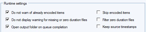

  15. Hi, how do I add the original file's date to it's output version?
    For example, I have "video.mp4" created on 14.02.2007 16:48, and I want it's encoded version to be named "video_14_02_2007_16_48.mp4", how can I do it for multiple files?
    I'm not an expert on this stuff
    Nov 2017
    Madrid, Spain
    Hi, just enable the "Keep time stamps" at settings
