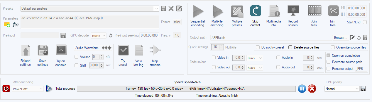

  5. Im having issues since installing the latest version.
    Issue one:- Avg detects ffmpeg as a virus.
    Issue two:- ffmpeg does not pass the checksum. (tried replacing also)
    Issue three:- progress bar see screenshot.
    Any thoughts?
Name:	Screenshot 2024-10-08 091708.png
    Nov 2017
    Madrid, Spain
    FFmpeg comes from https://www.gyan.dev/ffmpeg/builds/
    The ffmpeg Essentials 7.1 md5 is 9338f09bb6603073c163f16c4a99be12
    It is safe: https://www.virustotal.com/gui/file/2ce797a0f88d7f067180338fb227f7b1928ea727bd9a4d7a1d022f7c52af71a3
    ffmpeg 7.1 full version checksum is 8fc3669a8dab286d84d55fde494cae8d
    Just one flag: https://www.virustotal.com/gui/file/36a59b638b49f8e6c622f4de7c4c8aaf8442f30138a58882ee2af3f410e5fd5c
    You can safely consider them safe, or disable ffmpeg checking in FFmpeg Batch Converter.
    The progress bar indicates that ffmpeg is not yer able to display some progress information, that's the reason it displays N/A.
    Some files require more seeking, specially encoding h265 before they display such progress.

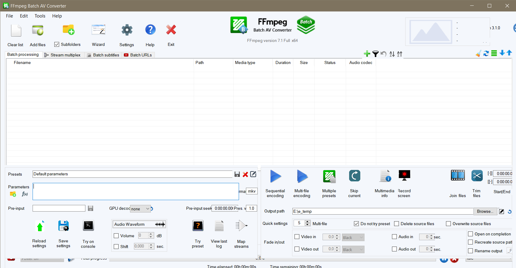

  18. I use a 1440p monitor and scale the Windows GUI to 125%. In previous versions, the program window was slightly blurred (upscaling), but everything was in place.
    Since version 3.1.0, everything is sharp, but there is a problem with the placement of window elements.
    [Attachment 83466 - Click to enlarge]
    [Attachment 83467 - Click to enlarge]
    Nov 2017
    Madrid, Spain
    The application was messed up when using scaling factor, apologize for the inconvenience.
    This patched 3.1.0 version should reverse the issue.
    I will release a patched version once it looks completely solved.
    Updated link

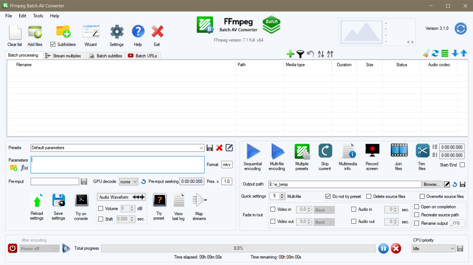

  20. I'm using installer version. Overwrite all files?
    Update: Not working, still displacement.
    Nov 2017
    Madrid, Spain
    That's bad, dpi scaling is being enforced somehow.
    I hope this new patched version fixes it. Just replace current files.
    NOTE: I've tried in Windows 10, it preserves app scaling.
  22. Win10, all files overwrited. All back to normal. Thanks for patch.

    The tradeoff is that improved startup time makes UI look outdated and somehow defective.
    Personally, I'm not at all displeased by the outdated look. Sure it's older looking but it gets the job done well!
    Originally Posted by Eibol View Post
    I've tested some partial reenabling of visual styles in my 4770S and visuals improve while keeping fast startup times.
    You can try it with this patched version (replace your current files).
    EDIT: Updated link.
    I'll check it out but the link is not working at all for me.
  28. Originally Posted by Eibol View Post
    This new link should work fine.
    Hi, thanks. It should not be the case with such workhorse, but over time application became somewhat bloated with too many controls on the main application window, which Windows does not deal with very efficiently.
    EDIT: Updated link.
    Got it. My browser still didn't like the download link for some reason. Shows the website as unreachable. That said, I fed the link directory into IDM and it downloaded it without an issue. Go figure.
    Okay, this patched version definitely loads faster than v3.1.1 but slower than v3.1.2 with the visual styles disabled. No surprise there. Loading time is much closer to having visual styles disabled vs the older loading time. Personally, I'll probably continue to use the software with visual styles disabled on the 6700K. Obviously, it looks way better with the visual styles enabled. Regardless, this should be an improvement for a lot of people. Quicker load times are a good thing!

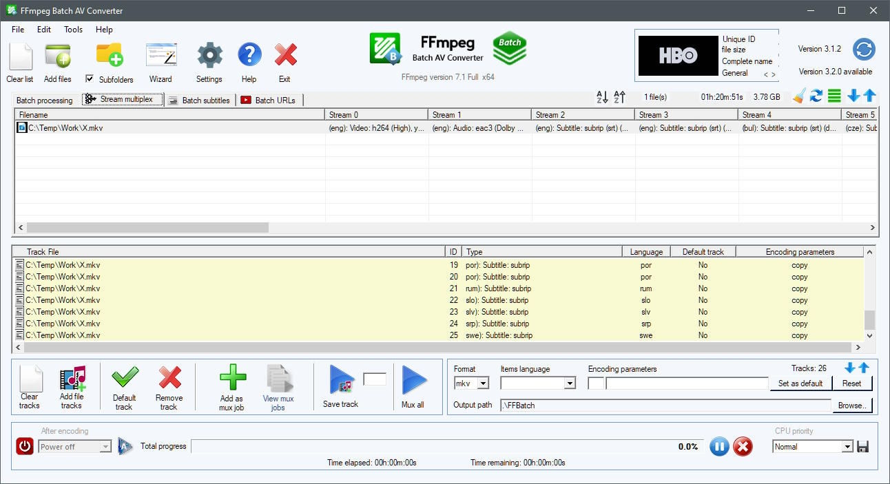

  29. Some issues with v3.2.0.
    1. After adding an item to the job list there is no longer a pop-up indicating the item was added and how many jobs there are.
    2. Subtitles. Some subtitles are showing up undefined under the Language column but you can see what they are under the Type column. This happens with v3.2.0 and not 3.1.2. FFBatch_mediainfo.exe seems to have no problem detecting the languages. Images attached
