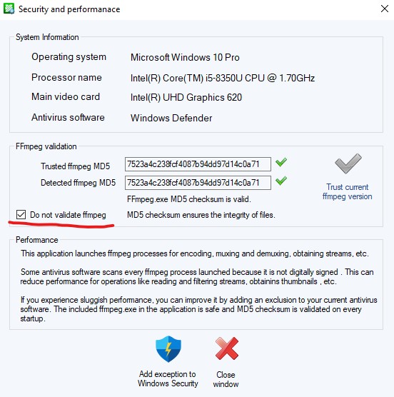

    Nov 2017
    Madrid, Spain
    Please try version 3.0.7, you can disable ffmepg.exe validation and get rid of your problems.
    [Attachment 80490 - Click to enlarge]

    EDIT: I updated to version 3.0.6 and after getting errors over and over about ffmpeg being corrupt, I finally found the version I use in the older Ffmpeg Batch Converter and after having to tell Windows it was safe to use (which I've never had to do before), version 3.0.6 finally opened for me. I loaded the 12 minute music file and version 3.0.6 had no problem encoding the mp3 in no time at all.
    FFmpeg_Batch_AV_Converter_Portable_3.0.1_x64 works fine but FFmpeg_Batch_AV_Converter_Portable_3.0.6_x64 has become unusable. Constantly getting the ffmpeg is corrupt error over and over. Even the one that v.3.0.1 uses from Hybrid. It tells me every single ffmpeg version on my machine is corrupt. Sometimes I can get by the error by giving it permission and sometimes I can't. I thought I had and tried to encode a folder and every file failed.
    Maybe put your own version of ffmpeg in the program folder so we don't have to go searching for one or get rid of the checksum altogether.
    Every single ffmpeg file I have works fine on it's own but ffmpeg Batch sees them all as corrupt.

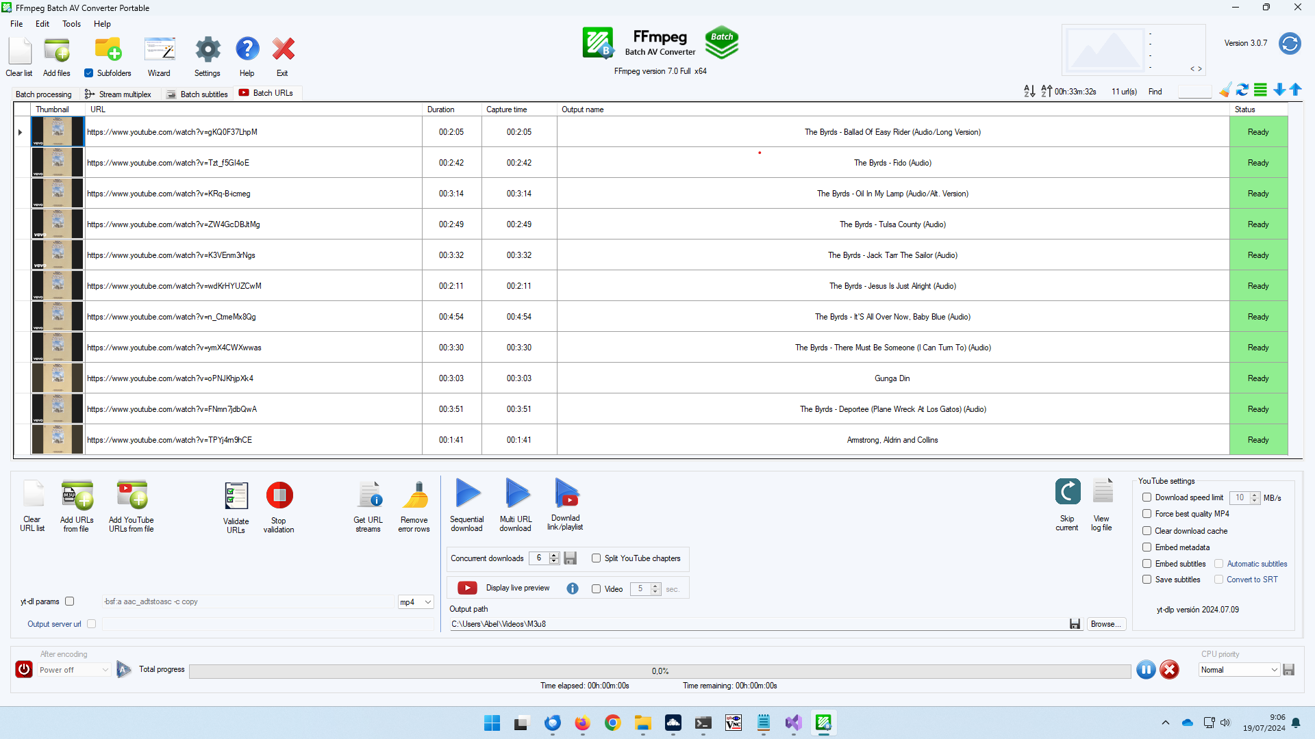

    Hi, are you adding youtube links?
    It maybe a bug.
    Could you send an example file?

    It doesn’t matter if I load “Ballad Of Easy Rider 1” or “Ballad Of Easy Rider 2”. Ffmpeg Batch AV Converter shows all the files but when it “Validates The URLs” it shows eleven copies of the last song on the list.
    If I load the URLs from “Ballad Of Easy Rider 1” one at a time, I get an error message about ffmpeg after each file is validated which I have to close to load the next file. This happens on every file. I don’t have that problem with “Ballad Of Easy Rider 2”.
    I put spaces between each file to see if it would help and I got an error message saying that some of the URLs are from youtube and some of them are not.
    Something else I’ve noticed is that after I process all the files, one file is missing in the output folder and I have to figure out which URL it is and reload it and process it again. I believe this is a bug with yt-dlp because when I use yt-dlp GUI, sometimes when I download a file, it acts like it’s downloading but nothing happens and I have to hit the download button again.
    It would be nice if yt-dlp showed opus as the audio file instead of webm so you didn‘t have to rename every file. Maybe you could put and opus option in the drop down box for the output type.

    I looked at the manual and noticed the address in the screenshot and it was shortened so I tried...
    https://www.youtube.com/watch?v=gKQ0F37LhpM
    ...and got an HTTP Error 403: Forbidden
    I used the address in Chrome and the Youtube page opened and played the video just fine.
    EDIT: All the other files showed ready so I re-validated the first file and it said ready so I clicked Sequential Download and it downloaded all the files.

    Hi, I've remove the optional url parameters and now validation seems to work fine and urls are not duplicated.
    [Attachment 80814 - Click to enlarge]
    You can try it this patched executable replacing existing one.
