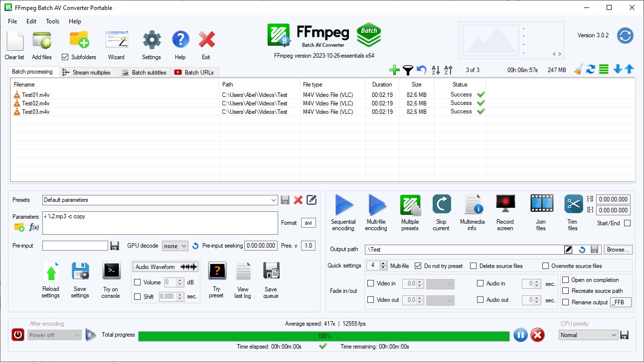

    I see. I think you could use variables to bach multiplex avi and mp3, but they would have to share the file name, like 'Name_track.avi' and 'Name_track.mp3'
    For example, if track01.avi and track01.mp3 exist, you would add all avi files to the list, and in the main tab:
    Parameters: -i %2.mp3 -c copy
    Format: avi

    Same problem. It created the first file with video and audio but failed on all other video files and produced avi files with audio only.

    You must be doing something different. This screenshot should help:
    [Attachment 74716 - Click to enlarge]
    You add video only files Test(n).avi to file list. Audio files are available at the same folder as Test(n).mp3
    Results in muxed Test1, Test2, Test3.avi

    2) start sequential single file encoding
    3) add another file to the list always by drag & drop
    4) wait first file encoding termination
    Now is the bug: second file in the list doenst start automatically, and if started manually very strange behaviour appears to the progress bar and other details about encoding
  26. Originally Posted by Eibol View Post
    Thanks for the bug report. It should be fixed for next release. This patched beta should work fine.
    Thanks for your work
