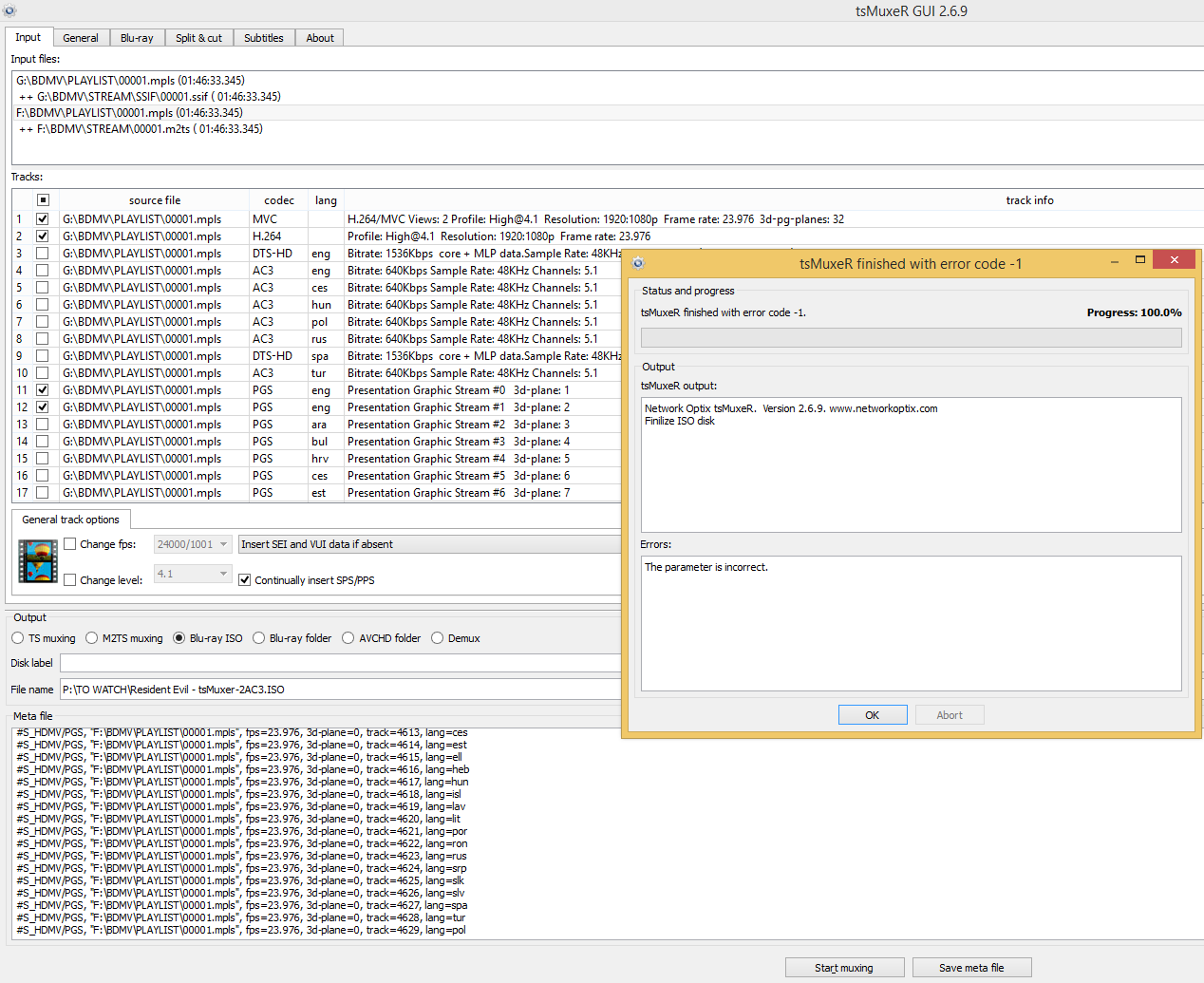

    Try mounting both your ripped source BD3D-iso and your Cinavia-free version. Using tsMuxer, from the original BD3D, import the playlist (MPLS) file that contains the 3D video. Also import the "Cinavia-free playlist".
    From the original, choose only both MVC and H.264 streams and your wanted 3D sups. Don't change 3d offset plane values for those. Remove the rest.
    Choose only the Cinavia-free audio from the other playlist. Remove the rest.
    Remux to BD iso and see if it works. I suggest using tsMuxeR version 2.6.9.
    Let us know if it worked?

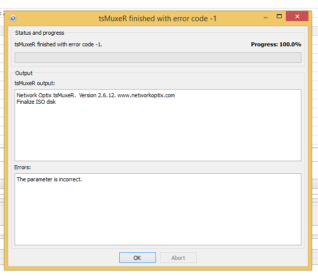

    Tried it with tsMuxeR version 2.6.12 and I got this error
    [Attachment 43869 - Click to enlarge]
