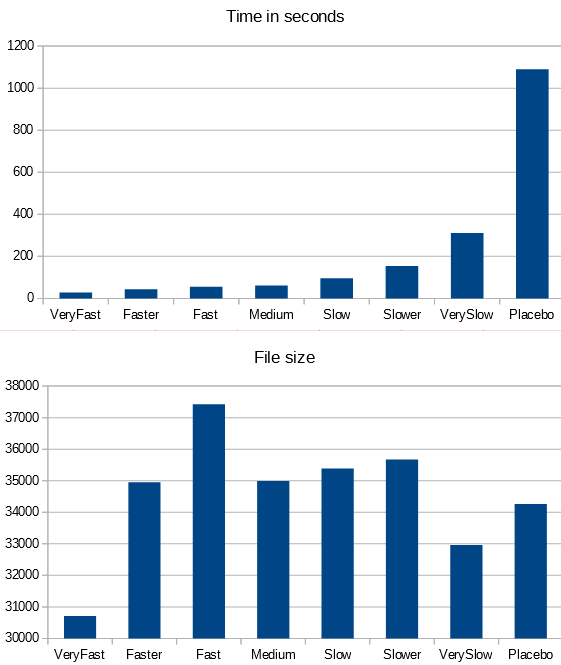

    The presets have been created to be roughly optimal positions on the speed-compression curve based on testing by the x264 developers.
    Funny thing about presets using same CRF fastest preset you suppose biggest filesize with fastest encoding but same quality as slowest. But what you get, is fastest preset smallest file, slowest preset biggest file. And because of speed is equal to presets name, so quality isn't same.
    By this I mean -> excepting same quality at given CRF with different presets, but it is apparently not what you get. Therefore presets are somehow weird and complicated in meaning what usual user except from them. And this is fastest biggest file, slowest smaller file.

  22. Originally Posted by Bernix View Post
    Well, you aren't. As you say it's a common misconception.
    That said, typically you will not find file size for constant CRF monotonically increasing as you go from fastest to slowest preset. Rather file size will decrease from preset "veryfast" to "veryslow"/"placebo". "ultrafast" and "superfast" often don't seem to fit the curve and that is mainly because they do not use mbtree which greatly changes the way CRF works.

  26. Member Bernix's Avatar
    Apr 2016
    Europe
    Here is what I mean. I do not used Superfast and Ultrafast. But all others are in graph.
    Do you see what I mean?
    Presets Very Fast, Faster and Fast. Then presets Medium, Slow, Slower. And finaly Very Slow and Placebo. I would except It will be other way round in file size.
    [Attachment 43865 - Click to enlarge]
    Bernix
  27. Yeah, it's not true for every source.
  28. Member Bernix's Avatar
    Apr 2016
    Europe
    I'm afraid it is. BTW source file was 3min long 50fps progressive. But I will not continue in this. If not for all, so for 99% of videos it will be same. If anyone proved me that is wrong or send me file which behaves in logic faster bigger, I will be very happy.
    Bernix
  29. Take away extremes and you are pretty much fine, this is CRF, that's priority, also speed by selecting preset. This is not exact ideal math algorithm science , but a magic with variables to keep the quality about the same, in a sense not to break it visibly too much, and also choosing encoding speed. Encoding is a patching up system that was tuned up as much as developer is capable of, size is not a priority using CRF. There is too many variables and they could be disabled, enabled at a point or make no sense from a certain point. You want something going faster or slower you must switch something on or off. It is a radical change, not gradual, it must show up somewhere.
  30. Member Bernix's Avatar
    Apr 2016
    Europe
    Therefore I said use CRF and at least 6 refframes subme9 and me method to umh. This is most powerful things in x264 from my POV. Or use Very Fast presets, as mentioned _AL_, there is not big difference in resulting video, but very fast is fastest and smallest file size.
    In fact, there is difference even on I frames, but hardly noticeable.
    VFvsMedium
    [Attachment 43871 - Click to enlarge]
    VFvsPlacebo
    [Attachment 43872 - Click to enlarge]
    It is not noticeable difference but when you equalize it you will see it. But it is without motion, just I frames comparison. I suggest at least try Very fast preset. Smallest file at maximum speed is guaranteed at given CRF.
