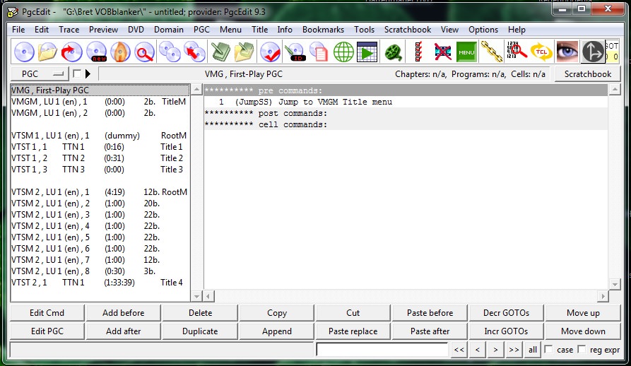

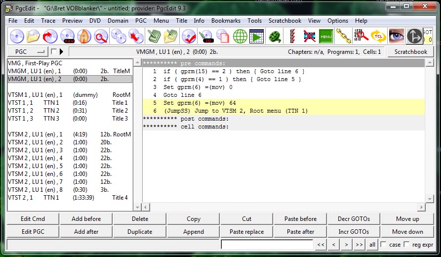

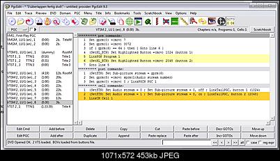

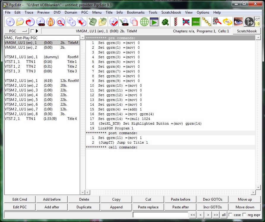

    Is it possible that my scratchbook is empty?! When i try to save it, nothing happens. And when i try to open it with the Button, in the upper right corner, there are no commands listed. :/
    I made 3 pics of the VMG domain instead, hope this helps:

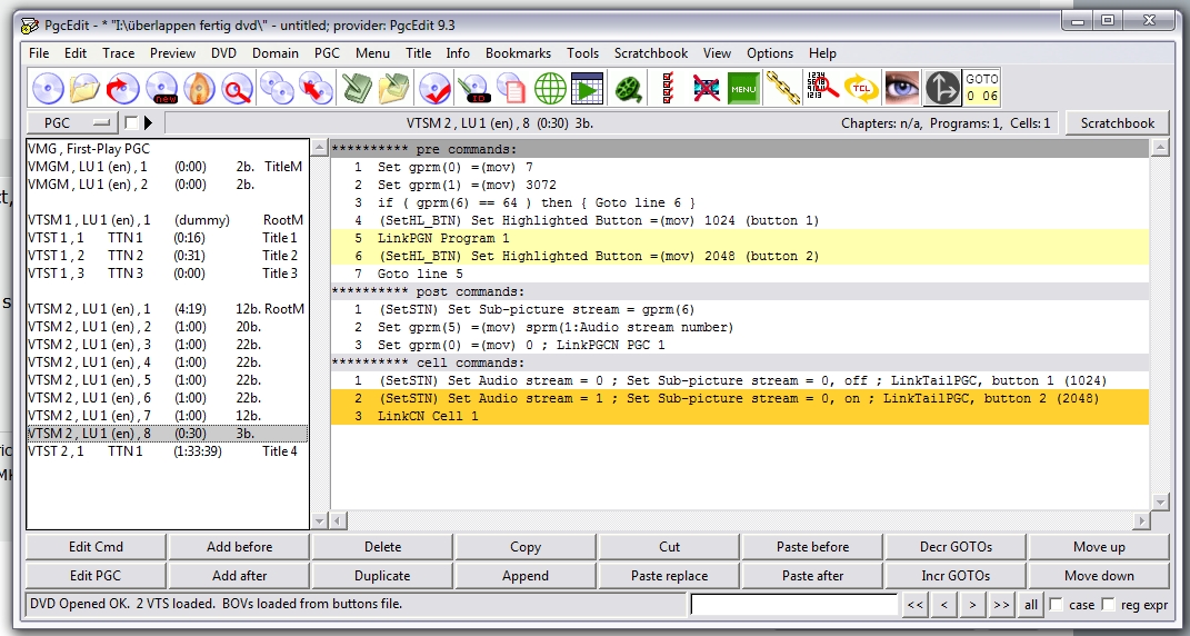

  17. Ok, just edited it and it works.
    I'm so happy, you helping me this and thanks a lot for your patience... but i noticed another thing. There seems to be some kind of interaction, depending wich button i choose in the "first play" menu...
    I try to explain:
    "First Play" Menu -> Button 1 (eng) -> Hit directly "Play" in Root Menu -> everything is fine. But no matter what i choose in the "Root" Language Menu, Audio will always be english.
    "First Play" Menu -> Button 2 (ger) -> Hit directly "Play" in Root Menu -> everything is fine. But no matter what i choose in the "Root" Language Menu, Audio will always be german.
    Subtitles are always "right" at all constellations.
    Maybe you have one last hint for me? Did i messed up something? Here is the current backup:
  18. Hum, at a first glance, I think that what I did is correct, but I'll verify tomorrow.
    But verify post command #2 in VTSM 2, 8:
    2 Set gprm(5) =(mov) sprm(1:Audio track number)
    And verify also if the two buttons of the second menu set the correct audio track.
