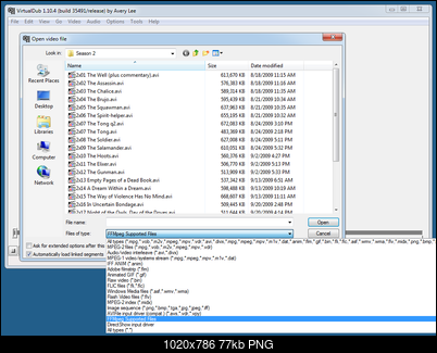

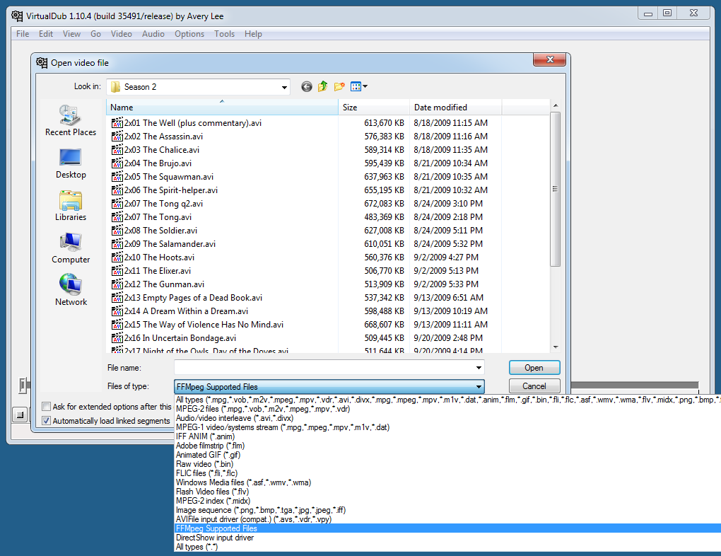

    I tried opening the file in standard VD as an ffmpeg file, and opened it in VDMod but I get the same error (source video uses compression algorithm not compatible with avi)
    So you used the pulldown at VirtualDub's Open Video File dialog to force the ffmpeg source filter?
    The ffmpeg source filter should have been able to decode the DV video. Or if you use the standard AVI source filter VirtualDub itself should be able to decode the DV. You may have to force the option VirtualDub -> Options -> Preferences -> AVI -> Prefer Internal Video Decoders...
