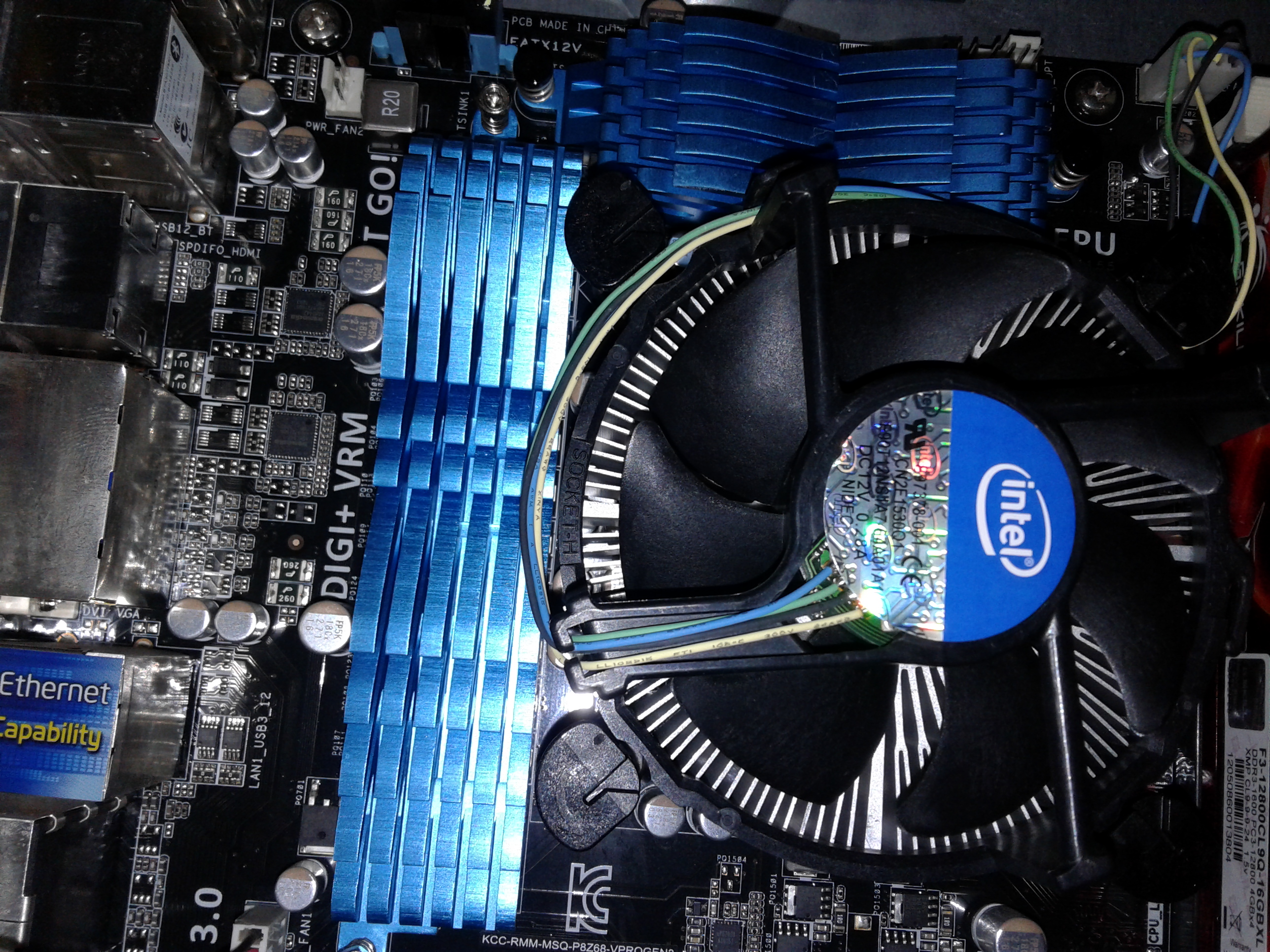

    I've checked all the plug/jacks; everything seems seated properly. My board is an Asus. Are you saying remove the two blue heatsinks are re-apply with thermal grease?
  6. No, the big circular heatsink with the fan. This is what is sitting directly on top of the CPU.

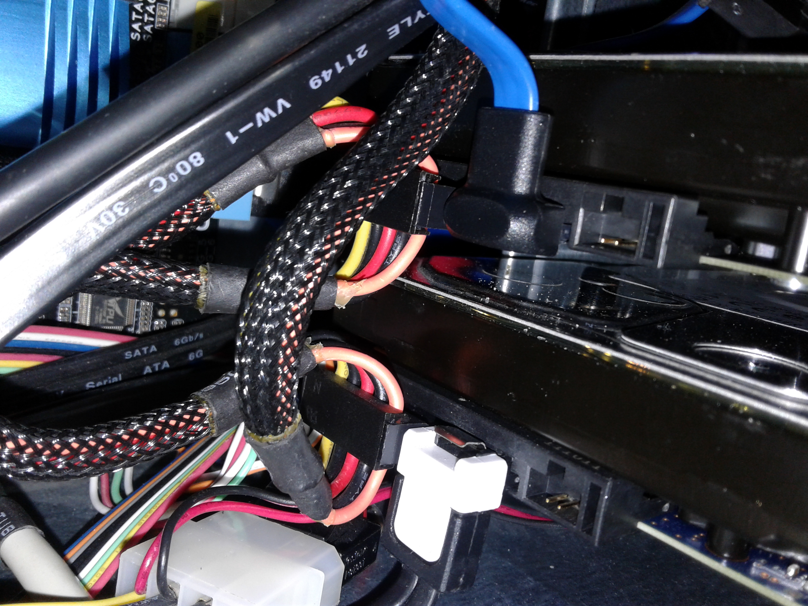

    I admit I can't remember which set of p/j's go to which hard drive?

  24. Originally Posted by clashradio View Post
    Check settings for SATA (AHCI vs Legacy) in BIOS. I can imagine that with resetting BIOS you lost proper SATA config.
    It is set to AHCI
    I would then try opposite setting ie legacy or compatible (have no Asus and don't remember they naming convention)
    In order to diagnose a screw-up with a Raid, it is important to have details of the configuration
    and all drives in the system, the way they were Before the screw-up.
    You can check sticker on HDD unless all disk are same vendor and same size + series.
    Also SATA port numbering may be helpful.
