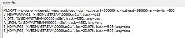

When i open in Gui tsMuxeR a m2ts stream make automatic the meta file :
[Attachment 43785 - Click to enlarge]
how can make this meta file from command line?

First, you drop your file onto tsMuxers GUI, unselect streams or leave them selected, whatever you need, thencopy that metafile. Like you already did basically.
Then make batch script that you are going to run. The part where you make that meta file will be:
(you did not post a text, I will not retype that image of yours, this is different example, just follow a pattern replacing your file with %~1, that is dropped file or first argument in batch file function)
that batch script will be more elaborate, that is the part where you design your particulat meta file, not sure how much you know or if this is the way you wanted to goCode:echo MUXOPT --no-pcr-on-video-pid --vbr --vbv-len=500 > "remux.meta" echo V_MPEG4/ISO/AVC, "%~1", insertSEI, contSPS, track=4113 >> "remux.meta" echo A_AC3, "%~1", timeshift=-39ms, track=4352 >> "remux.meta" "tsmuxer.exe" "remux.meta" new_%~n1.m2ts
Just note, I think, If I remember correctly, there was a bug in tsmuxer.exe, it cannot create new file like this with spaces in it because running command line with quotes as an output destination did not work. -
I have too many variables that I can write the meta file self.
- V_MS/VFW/WVC1 or V_MPEG4/ISO/AVC
- 15 Languages
- DTS, DTS-HD, LPCM
- 15 SUbs Languages
Regards -
You rip more Blu-Rays like that with tsMuxer? Meta files will differ a bit. Yes, Each BD is different. You'd need to generate new meta file for each BD.
Why don't you use eac3to.exe to get streams you want then muxing it into MKV (or tsMuxer). eac3to.exe is a tool dedicated to that. It demuxes streams of your choice from Blu-Ray to hardisk. Then you mux them. This has the same speed effect as copying them to hardisk and you copy only desired tracks.
Check ClownBD . It is a GUI that reads Blu-Ray and makes m2ts or MKV. It uses eac3to.exe to get those files (under its GUI's hood) -
