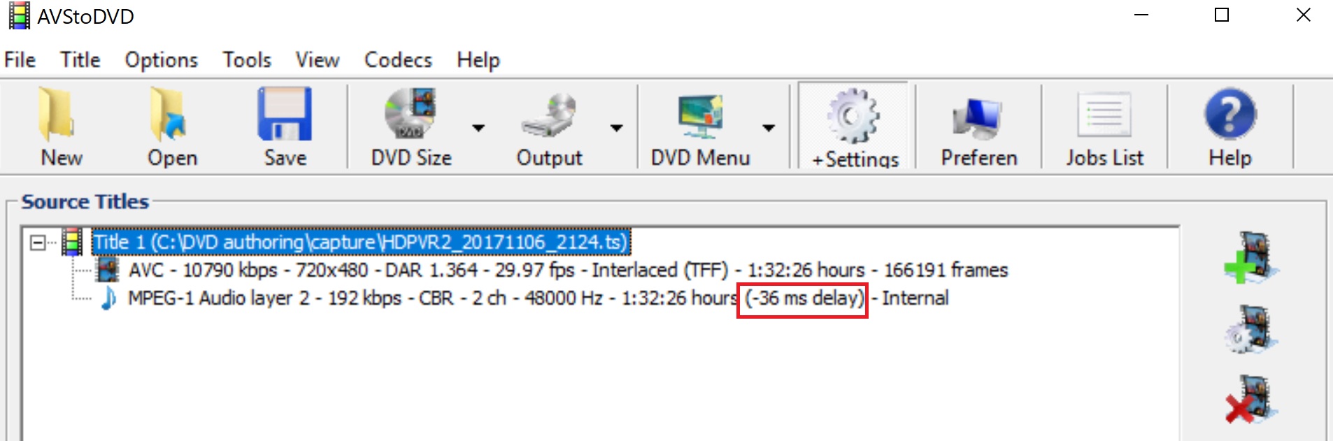

    I have tried this method but it didn't work. What I don't get is why is there a 36ms delay in the audio of the source file when it is added in AVStoDVD, does AVStoDVD think that this delay is in the source file or does it add the delay because it thinks the audio is out of sync with the video?
    [Attachment 44047 - Click to enlarge]

    _MrC_ is the best person to answer this but you could never detect that length of a delay by just watching the video and you already stated that it is in sync when watching.

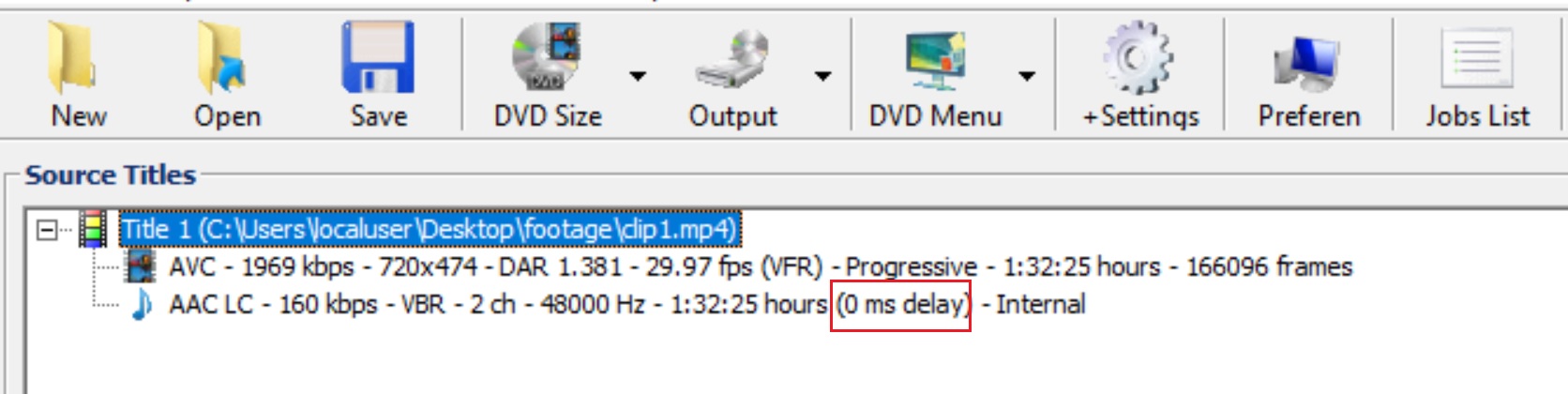

  7. Ok I solved my issue. I encoded the TS file to mp4 with Handbrake and once I loaded it into AVStoDVD there was no delay. I created the dvd structure and played it with VLC and now it plays fine. Now to burn onto a DVD do I just burn these 2 folders somehow or I set the output to DVD video in AVStoDVD and let it create the disc?
    I also noticed that the mp4 is 1.5gb in size where the TS file is 7.8GB in size, would converting to MP4 reduce quality or MP4 is much more compressed than the TS format?

    Video: C:\DVD authoring\capture\dvd output\christmas.mp4
    Info: AVC - 1969 kbps - 720x474 - DAR 1.381 - 29.97 fps (VFR) - Progressive - 1:32:25 hours - 166096 frames
    Audio 1: C:\DVD authoring\capture\dvd output\christmas.mp4
    Info: AAC LC - 160 kbps - VBR - 2 ch - 48000 Hz - 1:32:25 hours (0 ms delay)
    [MediaInfoLib - v0.7.77]
