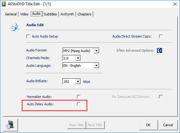

    I don't think I can specify the bitrate when capturing with my Hauppauge HD PVR2 and their software. I will try to create 2 captures but what I notice when I view the VHS tape on the tv, the sound comes on and then video follows shortly after but it seems to be in sync, well if its out of sync on the VHS, you can hardly tell. But I never thought of adding two video files when authoring the DVD, I am pretty sure this would make them play straight through like you mentionned.
  11. Originally Posted by johnnyh55 View Post
    When I play the source file in VLC the audio is in sync. When I take the same file and burn it onto a dvd, as soon as the movie gets to that halfway point the audio becomes out of sync. What could cause the source file to be ok but the authored dvd to have this issue? I have tried to use AVStoDVD
    In AVStoDVD, see Help/FAQ/General/Q1.5
    Bye
    MrC

  17. after i changed the encoder settings I just reloaded the save project and burned a new dvd, is that ok? or do i need to create an entirely new project with new menus for those new encoder settings to take effect?

  21. OK so I just tried with LAV as MP2 filter and I unchecked auto delay audio in Edit-title-audio and it did the same thing.
    Here is the log file:
    <12/16/2017 2:26:25 PM>
    START PROCESS

  22. Member DB83's Avatar
    Jul 2007
    A month ago you promised to upload a short sample video with the highlighted problem.
    The whole purpose of this is to see if the error is replicated or even if it can be fixed. Bear in mind that it was already stated that you should re-encode the audio which might itself fix it.
  23. I don't feel like putting the footage online as it's family content but how can I re-encode the audio with a different codec? can you explain the steps?
  24. Member DB83's Avatar
    Jul 2007
    Ok. I respect that decision although you could have made it a month ago and we could have moved on somewhat quicker.
    I use a somewhat older version of the program but I believe the principle is the same. Select the Title Menu (Top of screen) and chose 'Edit Title'. From the 'Audio' tab un-check 'Auto Audio Setup' and uncheck 'Keep DVD Compliant Audio'. From the dropdown list select AC3 and 256 (or 384) kbps. Click OK to finish the setup.
    Burn to folders >> Output >> DVD Folder Structure and test with vlc
  25. Member
    Mar 2008
    I would try to repackage the source file.
    First of all demux the mp2 and open in an audio editor (Audacity is free if you don't have one) and save it out as a wave file (PCM)
    Open the source ts file in MKVToolnix and add the new wave file. Deselect the mp2 from the output
    and mux the file to a new MKV, which should now contain only the video and the new wave file.
    Play the new mkv and make sure it stays in sync. If it does use this new file for you AVStoDVD project.
    As has been suggested, don't waste any more DVD media, create the video_ts and test first on VLC, mpc-hc, etc,etc
