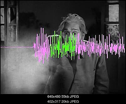

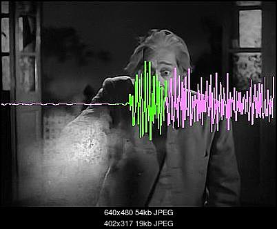

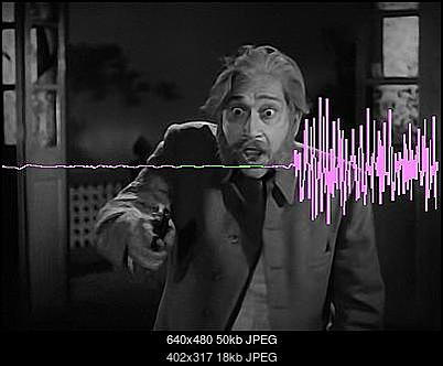

  9. I just checked and it's 32ms for AC3. You can adjust it in multiples of 32ms. For this kind of work I use AviSynth's Audiograph command. But I use WAV files with audio and video opened in Virtual Dub. You can delay the audio using the DelayAudio command. You can also do the same with AC3 audio, with the constraints mentioned earlier.
    A=AviSource("MovieFinal.avi").ConvertToYUY2()
    B=WAVSource("MovieFinal.wav")
    #B=B.DelayAudio(0.0)
    AudioDub(A,B)
    AudioGraph(2)
    Return Last

    But I think some delay of sound is desired.
    OT - just checked muzzle velocity, before manono posted pictures, and now I know why is there idiom something like "Sometimes you hear the bullet" it should be "shot" instead of bullet. According table here
    Bernix
