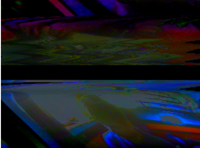

    Okay, the title sounds odd, I'll admit. I need my project to work without power. That is, a complete power failure may happen, and no additional power (such as a battery or supercap) is available mainly due to size and cost restrictions. The ground will always be connected during a power failure. The power failure may also include, for example, a short circuit placing the 3.3V buck regulator into a protection mode, causing a loss of power.
    Here is the scenario. I'm developing a video processor which has multiple video inputs (two in most cases.) It uses an analog switch TS3A24157 datasheet:http://www.kynix.com/uploadfiles/pdf9675/TS3A24157DGSR.pdf, depending on version) to select the desired video feed, all software controlled. With power, it selects either one. However, when no power is present, I don't get a good video signal, because the mux goes into some kind of null state, with both inputs kind of conducting but very weakly.
    The result is without power, a video picture which looks like this:
    [Attachment 43744 - Click to enlarge]
    The output amplitude is large enough to allow a TV card to sync onto it, but not large enough to provide a clear picture.
    So, I need some kind of circuit which activates when there is no power and passes through either video input (one or the other, but not both) as a sort of fail safe for when power is lost or a bad hardware problem occurs.
