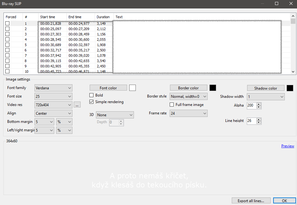

    [Attachment 43728 - Click to enlarge]
    What is wrong with style, there is plenty of option. Or you can export them as PNG and work with each separately. If is it worth of it.
    Bernix

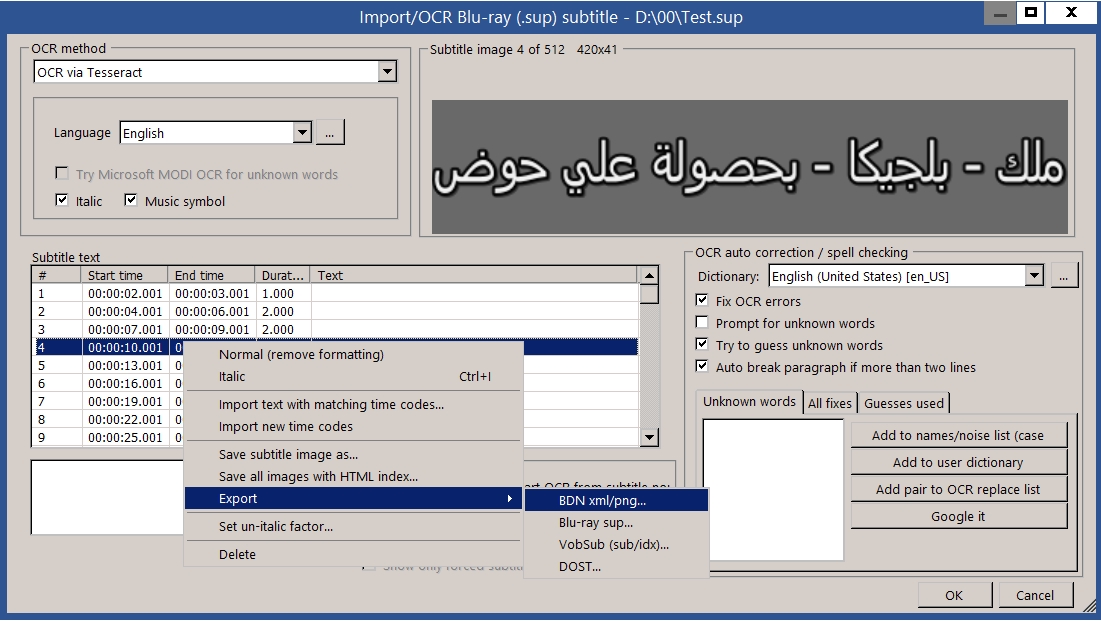

  8. You can do it with either BDSup2Sub or Subtitle Edit. For PGS:
    In BDSup2Sub drop the .sup file onto it. Export as XML/PNG. Edit the PNG in question. Drop the XML onto BDSup2Sub and export as SUP(BD)
    Similar in Subtitle Edit. File -> Import Blu-ray (Sup). In the OCR window Right click -> Export -> BDN xml/png. Edit the png and open the xml.
    [Attachment 43730 - Click to enlarge]
    You can do the same for vobsub.
