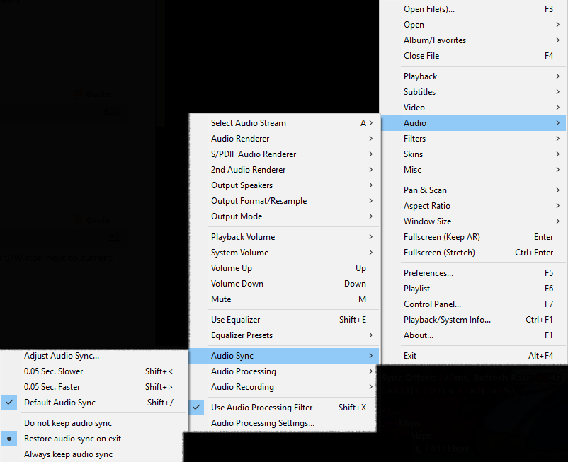

    [Attachment 43729 - Click to enlarge]

    Originally Posted by Bernix View Post
    Just noticed, video DSC is working only if you have set DXVA decoder off. So when on the bottom is S/W icon next to current time/duration. (not working when H/W)
    Did you try DSC in audio?
    EDIT or try post part of video if possible.
    Bernix
    yes i tryed Dsc in audio
