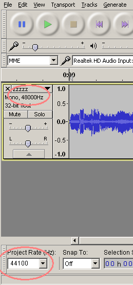

  4. Audacity seems to export audio using the "project sample rate".
    So you import some 44.1k audio. Audacity sets the project sample rate to 44.1k. You resample it at 48k. Then you export it and Audacity appears to resample it back to the original project rate of 44.1k unless you change it. At least that's what's happening for me.

    Yep, changing the project sample rate worked. Cheers.
