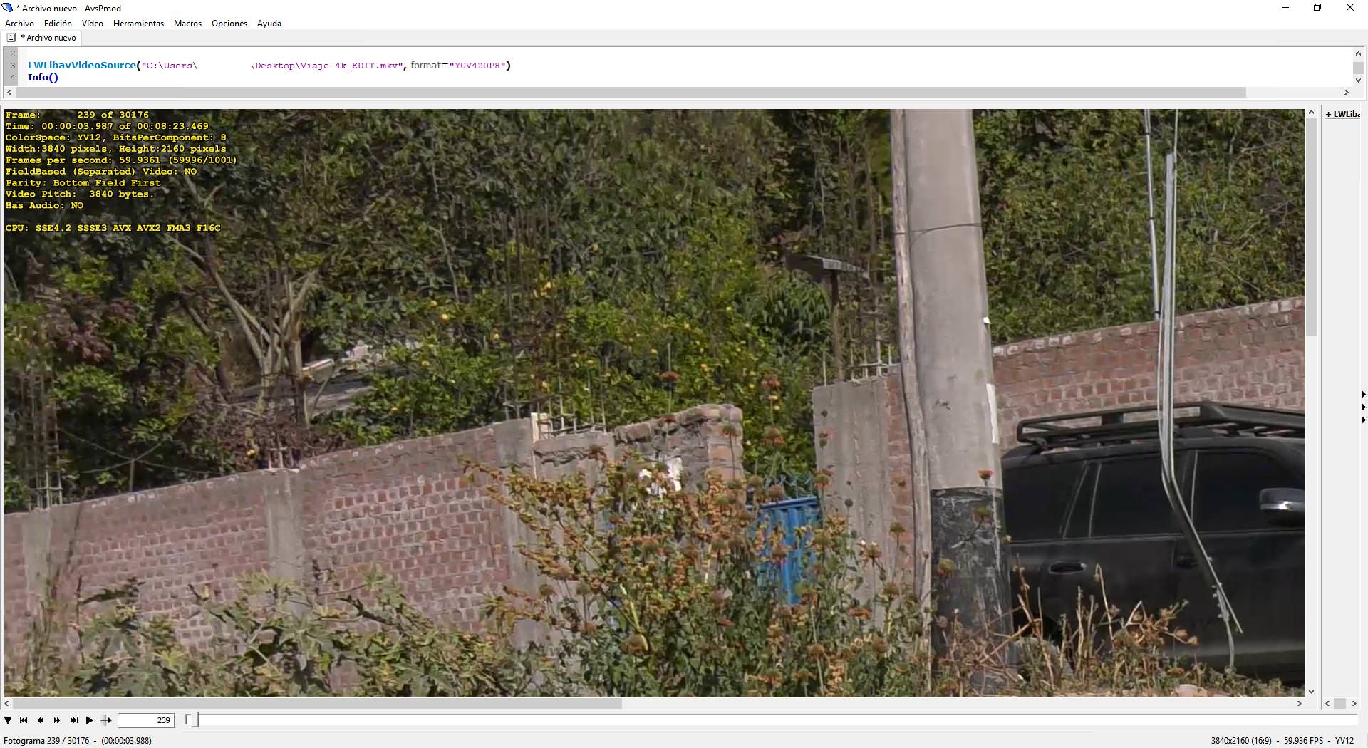

    I took a screenshot, maybe you can confirm if it would work, in the image has the info
    thanks so much
    https://forum.videohelp.com/images/imgfiles/RTRbOwq.jpg

  6. Of course it will work. Just be sure to encode it interlaced, top field first.
