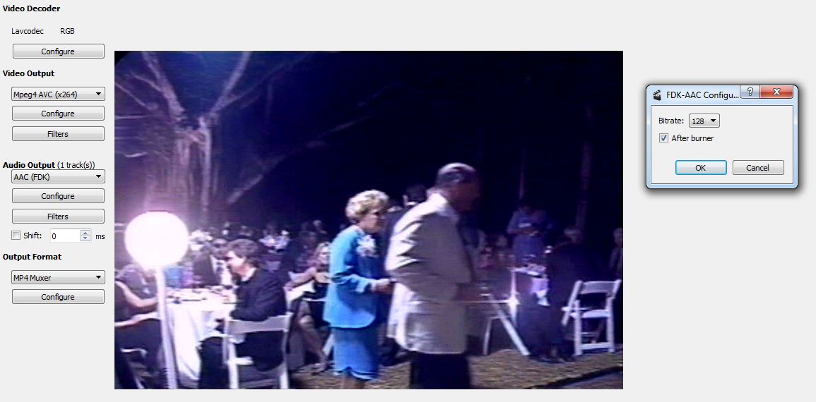

Hi Bernie,
Does this look right for the options?
[Attachment 43668 - Click to enlarge]

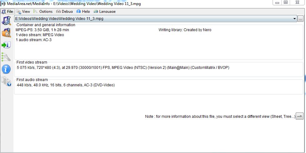

Here is what Media Info shows
[Attachment 43669 - Click to enlarge] -
Hi,
the problem is it is 450 MB with no sure it will be accepted. OP #1 it took 15 min. to upload 250 MB and no luck.
Edit: try what jagabo said. You get exact quality you have. If not success, try this, but in audio settings choose remix to stereo.
BernixLast edited by Bernix; 9th Nov 2017 at 17:26. Reason: EDIT

Hello All, the reduced video was only about 250Mb and I was able to upload it to both youtube and Facebook. I followed Bernix's advice with regard to settings and the quality is as good or possibly better than the original. The Mediainfo screenshot that I presented was based on the original file and not the reduced version.
