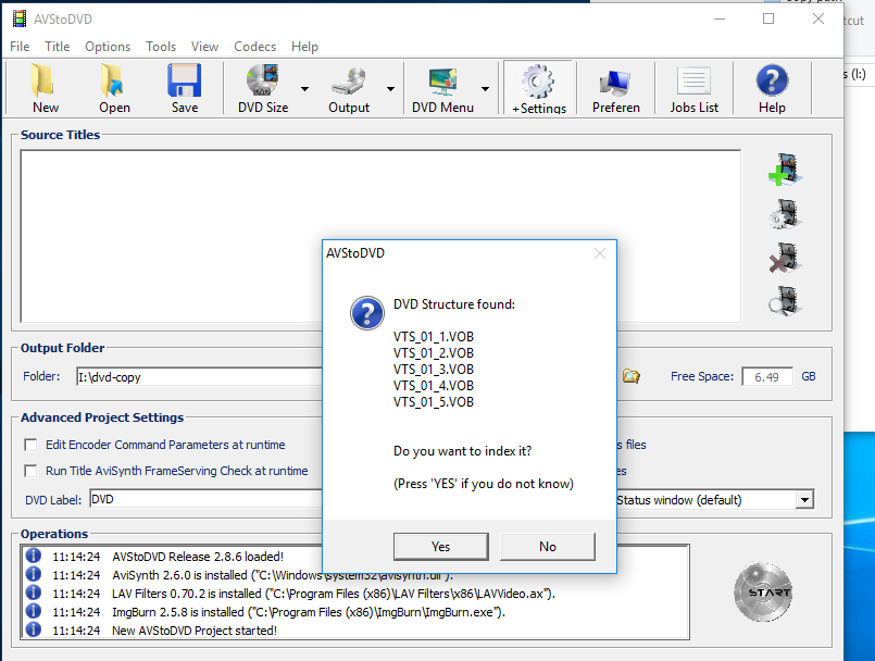

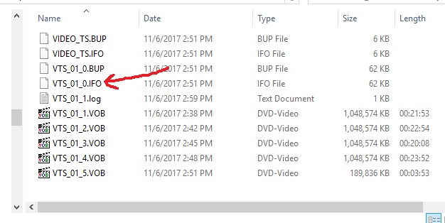

    I'm responding to a PM "eager to learn" sent me, I used DVDFab to rip the main movie.
    In my example, If no further process is required, it can be burned as-is since it's less that 4.3 GB
    For further processing in AVStoDVD, drag the IFO to the A2D window
    Reply "yes" to the indexing question.
