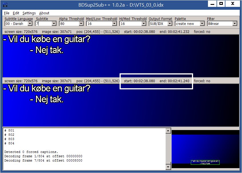

  3. loaded the .idx/.sub files into bdsup2sub
    Did you look at the timinig?
    [Attachment 43649 - Click to enlarge]

  6. Originally Posted by videobruger View Post
    I didn't check timing for each subtitle because I thought the point was to leave it on auto and the timing would be unchanged. But since the subtitles are mistimed in subedit even when importing the DVD vob files directly, I figured it can't be bdsup2sub that's at fault. In bdsup2sub, after loading the .idx/.sub files, the conversion options box pops up. Both "convert resolution" and "change frame rate" were left unchecked. I tried it again forcing 23.976 for both FPS source and FPS target in "change frame rate", and then output the .ifo/.sup files, but they still came out mistimed from dvdsubedit after OCR and export to .srt.
