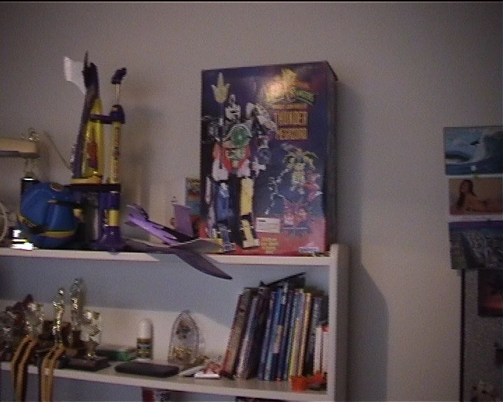

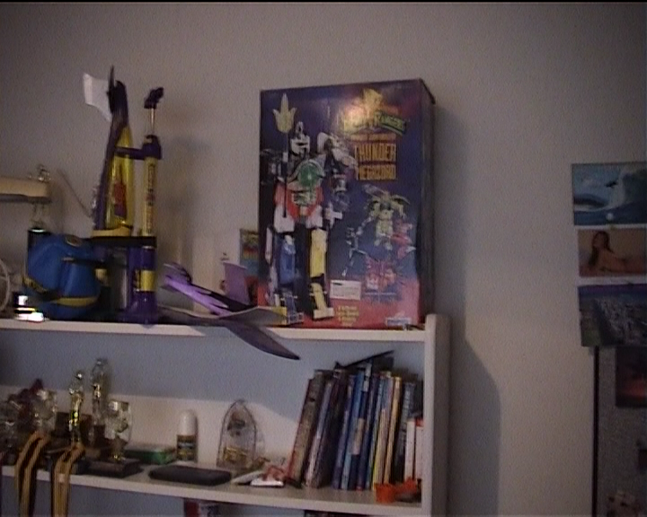

    Ok, fresh install AviSynth and QTGMC and now behaving as expected with the QTGMC result being best.
    Thanks for the help people.
    Below first pic is source (frame 10 from 25fps), others are frame 20 from processed output (50fps), last one is from fresh install "as expected" result from QTGMC

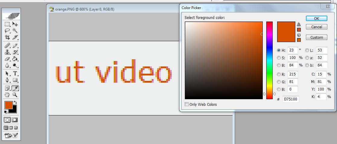

  10. It's all an illusion , there is even more colors in it , but you perhaps mean that color was not an issue and true answer in all of this thread ...
