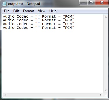

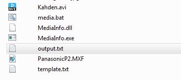

  15. Member Budman1's Avatar
    Jul 2012
    NORTHWEST ILLINOIS, USA
    If you are still interested in Mediainfo CLI then it can give you what you wish also. Detailed instructions and functions are included with the zip when you download the CLI. Then pick any of the hundreds of audio attributes and create a template.txt with such as:
    Audio;Audio Codec = "%CodecID%" Format = "%Format%"\r\n
    create a batch file with:
    mediainfo.exe --Inform=file://C:\Users\Bud\Desktop\mp3video\template.txt C:\Users\Bud\Desktop\mp3video\PanasonicP2.MXF > output.txt
    pause
    You can of course incorporate variables and %%a, etc. for drag and drop, but what you will get is:
    [Attachment 43620 - Click to enlarge]
    [Attachment 43621 - Click to enlarge]
    You can parse and import this information into batch variables. (https://stackoverflow.com/questions/3068929/how-to-read-file-contents-into-a-variable-...n-a-batch-file)
    This is only a rough outline but you should be able to adapt for what you want to do.
